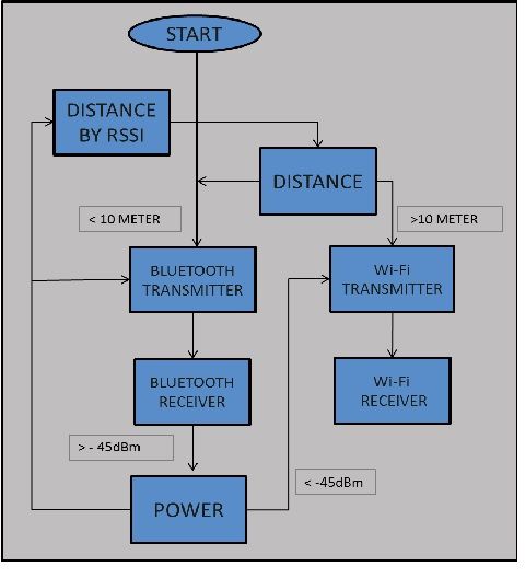

Phanirajkiran M
Senior
April 2, 2018
Posted on April 02, 2018 at 16:20
Does this above algo suits the RF switch.
Thanks
Phani
Andrew Neil
April 2, 2018
Posted on April 02, 2018 at 16:33
So you're not going to bother actually answering the XBee question, then?
But, from your diagram, I guess it must be a WiFi module?
Your flowchart doesn't really make much sense.
Anyhow, there isn't a straightforward, direct relationship between RSSI and distance.
I would suggest that you experiment with each radio separately, and understand each one's behaviour as the link fails, and as it becomes viable again.
You can't just transmit & receive - you will have to establish a 'connection'.
What will you do when neither path is available?
Note that both ends of the link need to be coordinated to know which radio to use
(this is easier with phones, because it's all IP - but that is not your case here).
