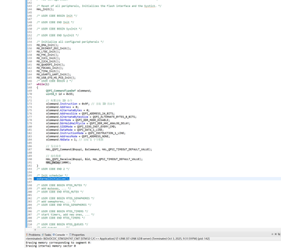

1、When I Start QSPI Work in main function,The QSPI Will always work。QSPI work on CM4-Core。
source:
The QSPI CS signal wave,which Delta Time is 13us,not big than 1s according code:
2、When I Start QSPI Work in FreeRTOS Thread,The QSPI-CS signal Always High,and clock is always out 。QSPI work on CM4-Core。
source:
The CS Signal is always High, And clock signal is always output.The next is qspi-clock signal:
My Question is:
1、When I Start QSPI transmit-receive in main() function, It will always work, no stop. It's CS-signal always output low and high. Why?
2、When I Start QSPI transmit-receive in FreeRTOS thread, It does not work, CS-signal is always High, and clock is always output.
I Have No Idea to solve it after many trial, Could You Have Some Idea?

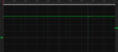

After My Test,I Can Confirm:QSPI will work OK when before osKernelInitialize() and osThreadNew() function; Not Ok when QSPI work after osKernelInitialize() and osThreadNew() function, also not ok when work in thread.
The below figure, is CSn signal, period is 1s, matched The code function
