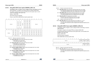

By default, timers continue to run in the background while the debugger is paused, and the debugger takes time to read out registers. There are freeze registers where you can change this behavior.

waclawek.jan
@TDK said above:
Just to elaborate on this, here are those registers:
Some debuggers may have a way to set them from the IDE, but you can as well set them also from code or even directly by manipulating registers in the debugger.
If the timers are *not* frozen, if the processor is stopped at a breakpoint and you reload the timers' registers view in debugger (again, this is IDE-dependent so can't give you a generic guideline), you'll see the timer's counter changing and status bits being set accordingly. Contrary to that, if you set the timers to be frozen, reloading the registers will show unchanging content.
Note, that if the processor stops at a breakpoint, it takes quite some time until the debugger finds out that the processor in the stopped mode, and reads out the timers' registers for the registers view. That's why if the registers are not frozen, the readout value differs significantly from the value which was at the time when the breakpoint stop actually occured. The freezing happens directly inside the chip, so that preserves the timer's value. There still may be a few cycles of lag for various reasons, though, so don't consider that cycle-precise.
The methodology described/preferred by @TDK and @Saket_Om - i.e. take timing data prior to stopping at the breakpoint - does not rely on this freezing feature and potentially may result in higher precision, if performed correctly.
