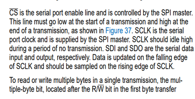

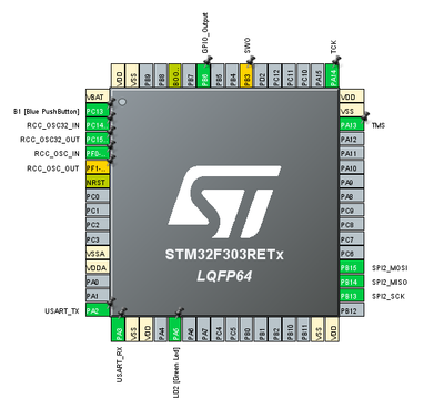

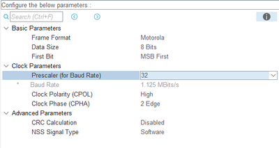

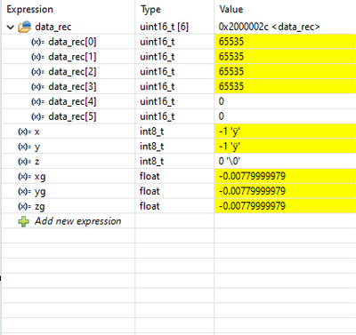

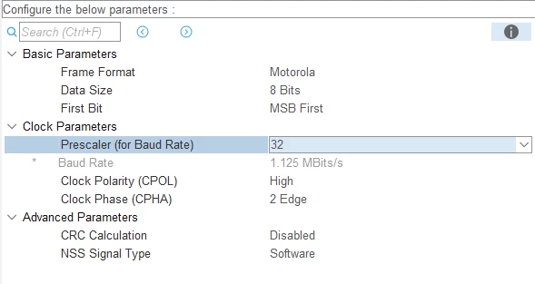

Hi, I’m having trouble reading measurements from the ADXL345 using SPI. I’ve attached a picture from the debugger that shows a view of the variables. The SPI is configured as master full duplex, and I’ve included a screenshot showing the SPI configuration. The SCK is connected to SCL, MISO to SDO, MOSI to SDA, and CS is connected to a configured output. I’m looking for help because I can’t figure out how to solve this issue.

Andrew Neil
November 11, 2024
Show a schematic of your hardware.
Please see the Posting Tips for how to properly post source code:
https://community.st.com/t5/community-guidelines/how-to-write-your-question-to-maximize-your-chances-to-find-a/ta-p/575228
What "trouble", exactly?
Can you successfully read the Device ID register ?
Are you sure CPOL and CPHA are correct?
Have you used an oscilloscope or logic analyser to check what's actually happening on the wires?

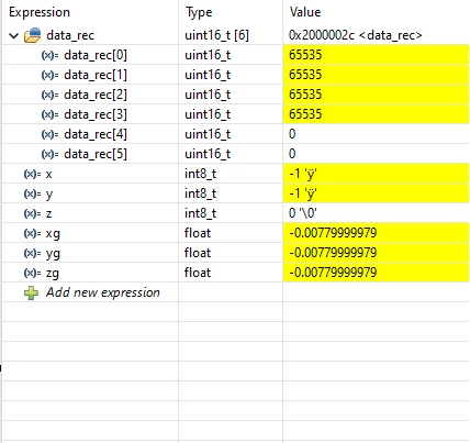

I tried this code with breakpoints, but the debugger was not reading the ID variable. Do you have any suggestions on how I could do this?

Andrew Neil
November 12, 2024
Again, see the Posting Tips for how to properly post source code:
What do you mean by that ?

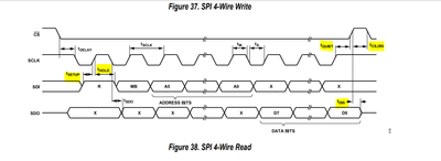

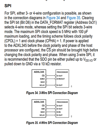

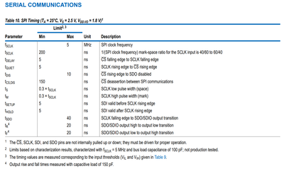

https://www.analog.com/media/en/technical-documentation/data-sheets/adxl345.pdf
As you can see in the attached debugger screenshot, the reading from the accelerometer — specifically, the X, Y, and Z position measurement from the data_rec buffer array — is incorrect. I don’t have an oscilloscope. I’ve shared images from the ADXL345 datasheet PDF; if you could kindly check whether it’s configured correctly, I’d appreciate it. I have attached the schematic of my microcontroller in a PDF, along with a screenshot. The connections are as follows: D13 to SCL, D12 to SDO, D11 to SDA, and D10 to CS.
Andrew Neil
November 11, 2024
Again, Can you successfully read the Device ID register ?
If you can't do that, then there's something fundamentally wrong with the comms - so no point worrying about X,Y,Z values!
November 15, 2024
I tried to read the ID using TransmitReceive, but it didn’t work; after the transmission, it shows the address 0x00. Does this mean that I have incorrectly configured the SPI registers? It's strange because I configured them as described in the text documentation. So, the only possible troubleshooting method is using an oscilloscope?
Or so you think.
