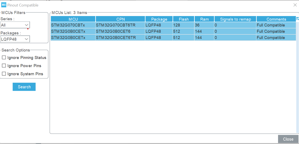

‎2022-09-25 11:22 PM
Hi @Guillaume K​
Thanks for the suggestions.
I agree with your statements that it would be tight to run everything in STM32G070CBT. I found a compatible SOC of STM32G070CBT. So my question is can I replace the compatible SOC of STM32070CBT without any hardware changes as my hardware is designed already?
‎2022-09-26 3:16 AM
Check the datasheets for (pin-to-pin) compatability.
Even if the datasheets say they are, I would still check the pinout diagrams including the pin descriptions - unless both chips are described in the same datasheet.
