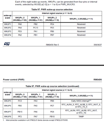

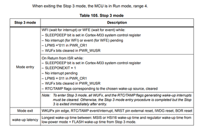

To wake-up the system from Stop 3 low-power mode, you should redefine PWR_S3WU_IRQHandler (From NVIC table) to handle the interrupt request, then clearing wake-up flags.
Check also the wakeup source selection :
According to the RM0456 (section: 10.7.9 Stop 3 mode), you can exit the STOP 3 mode using WKUPx pin edge, RTC/TAMP event/interrupt, NRST pin external reset, IWDG reset, BOR reset.
