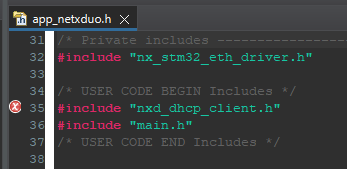

Hello @CharterWim ,
if you are regenerating with cubeMX and disabling DHCP addons it should compile and the includes should eliminated automatically.
You will find attached the file app_netxduo.c used to implement UDP Server with static IP.
BR
‎2024-05-15 1:03 AM
Hi @STea,
Thank you for your swift response.
The "nxd_dhcp_client.h" include is not removed automatically by CubeMx when disabeling the DHCP client.
I think this is because it is inside a USER CODE section in the demo application code.
But this is not a big problem for me. I just wanted to be very detailed in describing what I did- and didn't do.
