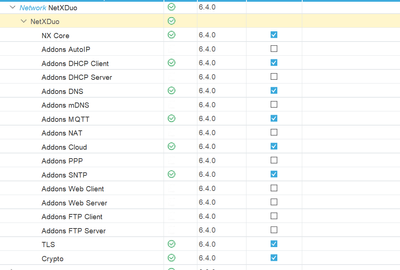

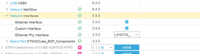

Hi currently i am using STM32H735G-DK ((DK32H75G$AT4) schematic pack MB1520-H735I-C02) for implementing Azure IOT using ThreadX
1. I followed example of NX_MQTT_Client it is working fine

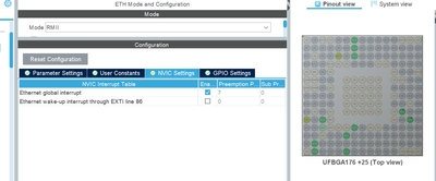

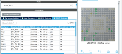

2. But i need to connect to Azure IOT via Azure c sdk i have added those and removed mqtt, freshly gen required things via cubemx using X-CUBE-AZRTOS-H7 and dhcp as client and ethernet (RMII) in interrupt
3. During assign ip via DHCP ip is not assigning and the ip_address_change_notify_callback() was not triggered i have followed same as NX_MQTT_Client but still it is not assigning
4. I have attached file for app_netxduo.c
NOTE: i have referred an example x-cube-azrtos-h5 for AZURE IOT but how to port this one to STM32H735G-DK (DK32H75G$AT4) schematic pack MB1520-H735I-C02 basically the folders and files of AZURE IOT how can we port ?
