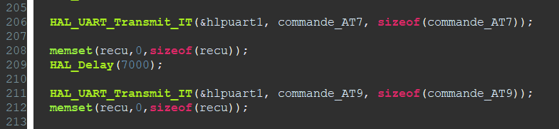

I'm using a NucleoWB55 and the LPUART protocole to communicate with a SIMCOM module. I'm able to send via the LPUART the AT commands that I want and to receive it's answers. I'm now trying to print on my terminal the content of my web page. I connected a USB to TTL (CP2102 module) to observe the UART RX of the SIMCOM module. The module transmits the entire content of the web page but I can't get it on my STM32 via LPUART. To make it easy to understand here are some screenshots :

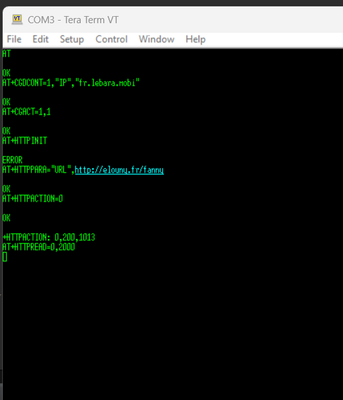

Here is the terminal where I transmit via UART the received data:

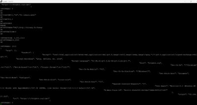

 We can see the entire content of the web page.

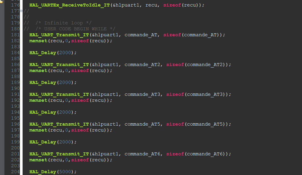

Finally the interesting parts of my code :

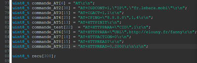

Commands and reception buffers:
I presume there's a problem in receiving and displaying the data received. I know my "received" buffer doesn't contain many characters at the moment, but I should still be able to receive the start of the page, shouldn't I?
Does anyone know what the problem might be?

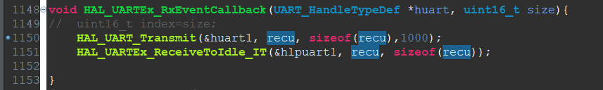

Don't use blocking functions (HAL_UART_Transmit) inside of an interrupt callback. Any characters caught during this time will lead to an overflow error condition. Perhaps set a flag and handle the transmission back in the main thread.
Monitor for errors by implementing HAL_UART_ErrorCallback or examining the software state machine (hlpuart1).
Don't mess with writing recu in the main thread--it may be being written in the interrupt. If you want to zero-initialize it, do so right before HAL_UARTEx_ReceiveToIdle_IT.

I used HAL_UART_Transmit_IT and it's working fine!
