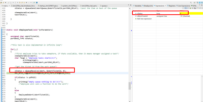

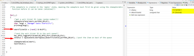

I have written below application. When manager task is scheduled for the 2nd time, the xStatus and xWorkTicketId get strange values as seen below.
When employee task is scheduled, xStatus gets "0" which indicates no variable in the queue waiting. This behaviour is strange, because there is variable in the queue.
Could you please help me sort out the issue ?

static void vManagerTask(void *pvParameters)
	unsigned int xWorkTicketId;
	portBASE_TYPE xStatus;
	xSemaphoreGive(xWork);
	/*the semaphore is created in the 'empty' state, meaning the semaphore must first be given using the xSemaphoreGive() API
	  function before it can be taken (obtained)*/
	for(;;)
		/*get a work ticket ID (some random number)*/
		xSemaphoreTake(xWork,portMAX_DELAY);
		char *msg1 = "manager tasks starts\n\r";
		printmsg(msg1);
		xWorkTicketId = (rand() & 0x1FF);
		/*send the work ticket ID to the work queue*/
		HAL_GPIO_TogglePin(GreenLED_GPIO_Port,GreenLED_Pin);
		xStatus = xQueueSend(xWorkQueue,&xWorkTicketId,portMAX_DELAY); //post the item on back of the queue
		taskYIELD();
static void vEmployeeTask(void *pvParameters)
	unsigned char xWorkTicketId;
	/*this task is also implemented in infinite loop*/
	for(;;)
		/*first employee tries to take semaphore, if thats available, then it means manager assigned a task*/
		char *msg1 = "employee tasks starts\n\r";
				printmsg(msg1);
		/*get the ticket id from the work queue*/
		xStatus = xQueueReceive(xWork, &xWorkTicketId, 0);
		HAL_GPIO_TogglePin(OrangeLED_GPIO_Port,OrangeLED_Pin);
		if(xStatus != pdPASS)
			printmsg("empty queue nothing to do!\n\r");
			/*employee will call a function to do the work*/
		else
			EmployeeDoWork(xWorkTicketId);
		taskYIELD();

xWorkTicketId is an int in one place and a char in another.  Probably not what you want?
