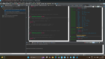

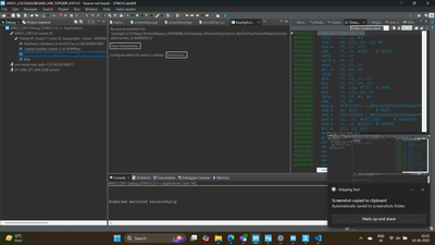

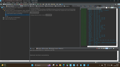

However, when I customized the gauge's background and needle graphics, I started encountering errors, including:
  • TouchGFX rendering errors (specific message attached in screenshot)
  • Occasional Hard Fault exceptions
I would appreciate your insights on what might be causing this issue—especially whether it could be related to memory constraints, asset sizes, or configuration mismatches.

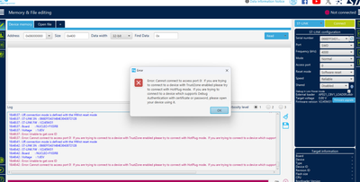

Hello @naveen ,
Are you able to see something triggering the hardfault? After x minutes of running? After clicking on the screen? Once the needle reach a certain point?
The screen shots tells me that issue happens while calculating the bilinear interpolation of the edge pixels but not much more.
Could you share the assets that works and the one that doesn't?
Also, why can't you connect to STM32CubeProgrammer?
