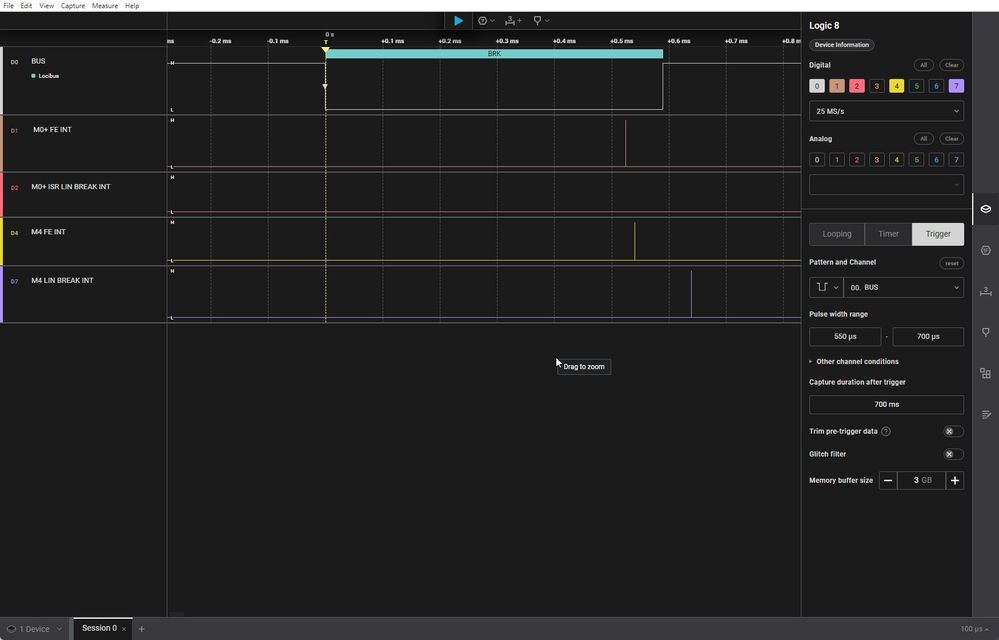

I am developing an application which makes use of LIN break interrupts. At the moment I am using two STM32 dev boards:
STM32C0116-DK ( which uses STM32C011F6U6)
STM32 NUCLEO G531 (which has STM32G431KBT)
We are using the LL drivers interface.
Although one processor is Cortex-M0+ and the other is M4, the description of the USART operation seems the same for each processor, as does the low level interface.
However, we are seeing very odd behaviour on the C11 (Cortex M0+) platform - we get the LBD interrupt, but it happens a considerable time after the break.. On the M4 platform we see the interrupt a few us after the break is done.
UART config and ISR implementation is the same on each platform. (Most of it is generated by Cube.) Here is the code for UART initialisation:

And here is the ISR:
void USART1_IRQHandler(void) { /* USER CODE BEGIN USART1_IRQn 0 */ // we just clear and ignore framing and overrun errors if( LL_USART_IsActiveFlag_ORE(USART1) ) { LL_USART_ClearFlag_ORE(USART1); return; } // BREAK can also have Framing error, so process it first and clear it too if( LL_USART_IsActiveFlag_LBD(USART1) ) { debug_io_iface(2, 1); LL_USART_ClearFlag_LBD(USART1); LL_USART_ClearFlag_FE(USART1); return; } if( LL_USART_IsActiveFlag_FE(USART1) ) { debug_io_iface(1, 1); LL_USART_ClearFlag_FE(USART1); LL_USART_RequestRxDataFlush(USART1); return; } if ( LL_USART_IsActiveFlag_RXNE_RXFNE(USART1) ) // received byte? { locibus_uart_receive_one_byte(); LL_USART_RequestRxDataFlush(USART1); return; } if ( LL_USART_IsActiveFlag_TXE_TXFNF(USART1) ) // transmit done? { LL_USART_ClearFlag_TXFE(USART1); LL_USART_ClearFlag_TC(USART1); LL_USART_ClearFlag_TCBGT(USART1); uart_send_one_byte(); return; } /* USER CODE END USART1_IRQn 0 */ /* USER CODE BEGIN USART1_IRQn 1 */ /* USER CODE END USART1_IRQn 1 */ }
View more
Some explanation : as we expect Framing errors during the break (this is documented in the datasheet) we "throw away" these interrupts.
The calls to debug_io_iface() just generate some narrow pulses on spare GPIO pins which we look at with the analyser to check timing. We generate a "break" pulse of about 600us (baud rate is 19200) every 100ms  This is what we see for the Cortex M4 chip. As expected we see the Framing Int during the break, it is discarded, then the BREAK int is raised just after the rising edge of BREAK as expected.

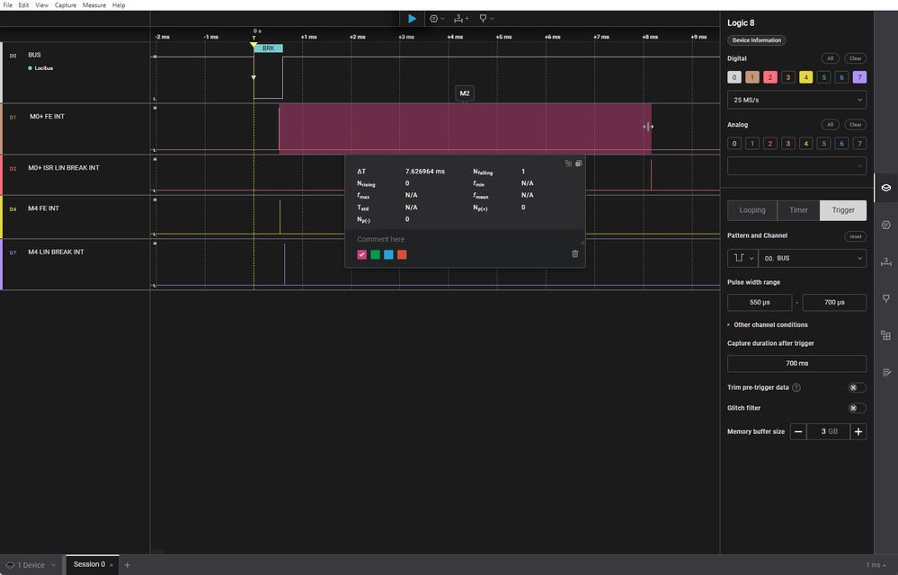

Here is the zoomed out image showing the interrupts of rthe M0+ chip. We get the FE at pretty much the same time as for the M4, but the BREAK interrupt does not happen for another 7ms ! Much later than expected.
What is going on?
I should also note that I have seen some other odd behaviour with the M0+ chip - sometimes GPIOs seemed to stop working and then were OK again, things like that. It is almost as if something basic in the setup of the chip is wrong - but I checked everythingI could (chip selection, clocking ... ) and all seems OK. Also CubeMX generates code with no warnings.
Any ideas? Thanks in advance for suggestions.
OK, I discovered the issue - there seems to be a signal issue on my board. Thanks for the suggestions, and apologies for wasting your time.

Have you check for other IRQs that maybe causing an overall system lag?
Kind regards
Pedro
AI = Artificial Intelligence, NI = No Intelligence, RI = Real Intelligence.
hi Pedro, indeed, that was also one of my suspicions - I have even turned off the SysTick interrupt, also removed pretty much every piece of code that can be. My main loop is just a while(1) as well.
I've also checked that the first (Framing Error) int returns quickly (tried removing the UART flush and also added a pulse right before the return, that is not the issue.
I'm still looking to see if I missed something *** - happens to the best of us, but I do not see it. I keep looking.
Can you toggle a pin inside your while(1) loop, and check the iteration time?
Then turn SysTick back On, and check again?
Kind regards
Pedro
it is about the same either way - very short, like 800ns.
Can you move the Pin toggle to inside the SysTick Interrupt handler, and check it again?
Kind regards
Pedro
