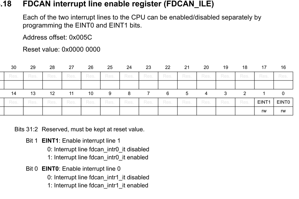

The conclusion is that setting filters and interrupts on FIFO0 leads to exception handling
FDCAN1_IT1_IRQHandler.
The reason for this behavior is an error in the file. startup_stm32g431cbtx.s
ERROR
.word ADC1_2_IRQHandler
.word USB_HP_IRQHandler
.word USB_LP_IRQHandler
.wordh FDCAN1_IT0_IRQHandler
.word FDCAN1_IT1_IRQHandler
.word EXTI9_5_IRQHandler
.word TIM1_BRK_TIM15_IRQHandler
This is how it should be
.word FDCAN1_IT0_IRQHandler

It took me several hours to understand that someone had screwed up.(
RM0440
Sometimes it blows my mind too))

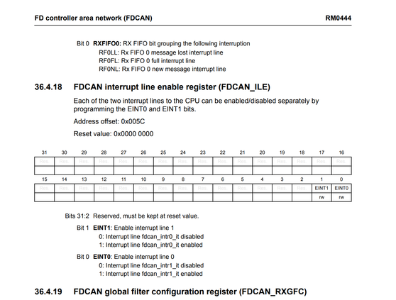

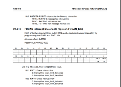

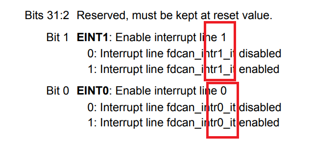

Hello Elmü
You were right, it’s just a *** typo in the RM for G0, G4, and H5 — a classic copy-paste error. I actually found an old project where I misconfigured FDCAN1->ILS and forgot about it, but it stuck in my head as if it were some "special feature" of that chip )).
I wrote some nonsense here, but the most important thing is to admit the mistake rather than just arguing forever )).
I rewrote the test code from scratch and verified everything: it works exactly the same way as on the H7 )))

Following the logic RM0440
FDCAN interrupt enable register (FDCAN_IE)
Bit 5 RF1LE: Rx FIFO 1 message lost interrupt enable
0: Interrupt disabled
1: Interrupt enabled
Bit 4 RF1FE: Rx FIFO 1 full interrupt enable
Bit 3 RF1NE: Rx FIFO 1 new message interrupt enable
Bit 2 RF0LE: Rx FIFO 0 message lost interrupt enable
Bit 1 RF0FE: Rx FIFO 0 full interrupt enable
Bit 0 RF0NE: Rx FIFO 0 new message interrupt enable
FDCAN interrupt line select register (FDCAN_ILS)
Bit 1 RXFIFO1: RX FIFO bit grouping the following interruption
RF1LL: Rx FIFO 1 message lost interrupt line
RF1FL: Rx FIFO 1 full interrupt line

FDCAN interrupt line enable register (FDCAN_ILE)
Bit 1 EINT1: Enable interrupt line 1
0: Interrupt line fdcan_intr0_it disabled
1: Interrupt line fdcan_intr0_it enabled
Bit 0 EINT0: Enable interrupt line 0
0: Interrupt line fdcan_intr1_it disabled
1: Interrupt line fdcan_intr1_it enabled

What you mean is this on page 2001 of the RM0440:
But to me this seem to be a typo in the manual.
Did you test this in the real world, or do you blindly trust the manual ?
Hello @Elmue , and sorry to be late.
Nice catch. It seems indeed to be a typo.
In the reference manual RM0433 (STM32H7):
I'll escalate it internally for fix. I'll keep you informed for the follow-up. Internal ticket number 227954 (not accessible by the community users).

The same FDCAN core as on the STM32H503  RM0492
Hello
> do you think that's a typo there as well?
It is not impossible.
May be there was an error in the G0 manual that has been copied to the G4 manual.

Elmü
Hello Elmü
