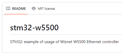

Do you think i can get inspiration from here to make a working example of st communicating with wiznet7500 in uart ?
https://github.com/afiskon/stm32-w5500/blob/master/Src/main.c
Thanks
That's something completely different!

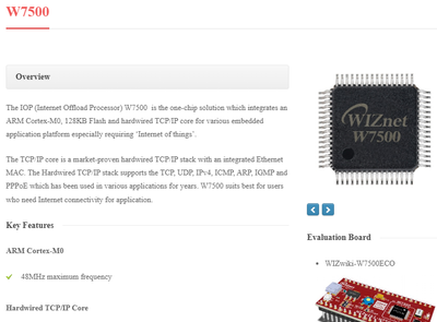

The Wiznet W7500 has its own on-board Cortex-M0, plus the well-known Wiznet "hardware" TCP/IP Stack:
https://www.wiznet.io/product-item/w7500/

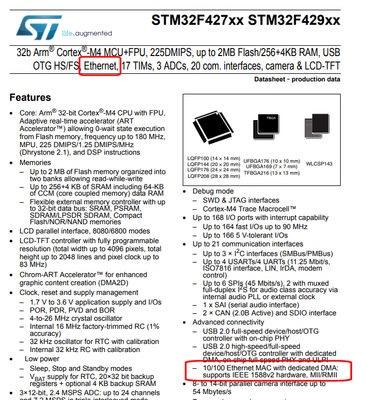

If you've got an stm32f429, why do you need a Wiznet with its own on-board Cortex-M0?
Wouldn't it be better to use a Wiznet with just the  "hardware" TCP/IP Stack?
Or just run a software TCP/IP stack on the stm32f429?
It has Ethernet - so why would you add an external ethernet chip??
