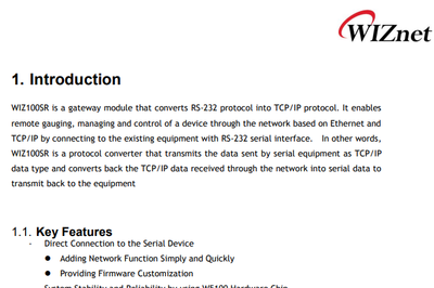

@SGasp.1 wrote:The wiznet has been programmed with the following fw .
https://docs.wiznet.io/Product/S2E-Module/WIZ750SR/download
So the Serial-to-Ethernet firmware?
So you've read the User Manual:
The whole point of such a device is that it's transparent - the things connected to it neither knonw nor care that it's there.

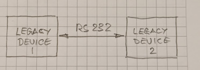

It's for converting a "legacy" situation like this:
to this:
So the "legacy" devices remain blissfully unaware that they are not actually connected directly by the RS232!

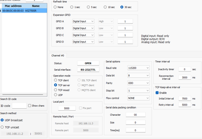

Let's suppose i want to validate all the hw of the electronic board..
The stm mcu has a direct connection with uart with wiznet..
Makes to test this connection right?
It is clear that the setting of the uart for both chips must be the same..

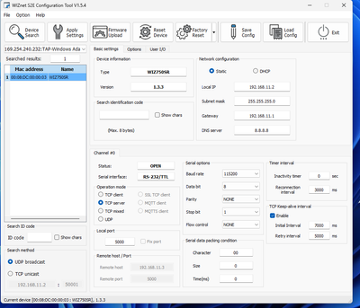

For stm32 it is easy i have cube ide and for the wiznet i have the following amazing tool
Once this step is done i have to communicate -- correct ?

taking this
Again, don't start by trying to test the complete chain.
Then verify that you can communicate using a terminal app on a PC through the Wiznet. DONE WITH THE APP PROVIDED BY WIZNET READING THE MAC ADDRESS ON THE GUI
Start by verifying that you can communicate from the STM23 via UART direct to another UART - eg, a terminal app on a PC.
