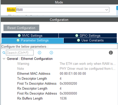

Here are the configurations of our system:
Not using RTOS, using lwIP.
Using external crystal 25mhz, not same as Eval board that from STlink, so RCC select HSE Crystal/Ceramic Resonator instead of BYPASS clock source.
CPU set as 550mhz.
MPU setting: flash.ld
/* Specify the memory areas */
MEMORY
ITCMRAM (xrw) : ORIGIN = 0x00000000, LENGTH = 64K
DTCMRAM (xrw) : ORIGIN = 0x20000000, LENGTH = 128K
FLASH (rx) : ORIGIN = 0x08000000, LENGTH = 1024K
RAM_D1 (xrw) : ORIGIN = 0x24000000, LENGTH = 320K
RAM_D2 (xrw) : ORIGIN = 0x30000000, LENGTH = 32K
RAM_D3 (xrw) : ORIGIN = 0x38000000, LENGTH = 16K
Descriptors are in D2_SRAM area
What else I could missing?  Any manual changes that I need to make?

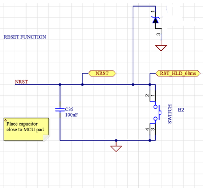

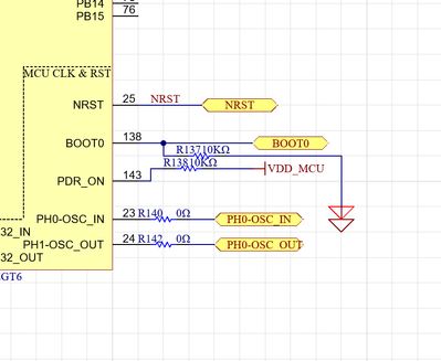

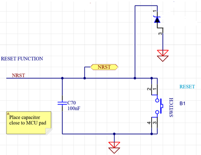

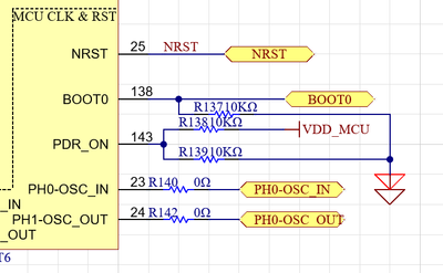

Here are two changes made in the hardware:
one was PDR_ON signal Pin 143 had two resistors R138 10k to VDD and R139 10k to ground. Change made to remove R139 to ground.
Before
After
2nd change was to add the delay to the RST pin to keep it stay grounded for 68ms upon power up.
Before change:
After change
Let me know what you think.  Appreciate your help.

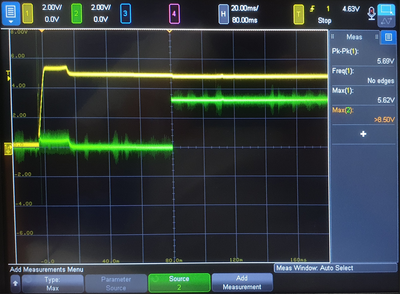

Hello @ETong.1 ,
  1. can you confirm that the modification to the RST circuit inserted the 68ms you which to have if you can send the snapshot of the scope showing the behavior of the RST ?
  2. why did you remove the resistor connecting the PDR_on to the ground ?is there a practical reason behind this change ?
Best Regards
ETong.1
Hi @STea ,
1. Here is the scope shot of RST:
On the scope ch1 shows the 5v signal with no delay. Ch2 shows the 3.3v signal which is delayed and used to hold the NRST pin Low for that time. (~68ms theoretical, measured ~80ms).
2. Hardware designer found it from this ST application note:
https://www.st.com/resource/en/application_note/an5419-getting-started-with-stm32h723733-stm32h725735-and-stm32h730-value-line-hardware-development-stmicroelectronics.pdf
For packages embedding the PDR_ON pin, the power supply supervisor is enabled by holding PDR_ON high. Thus, the resistor connecting PDR_ON to ground was removed.
Thanks
