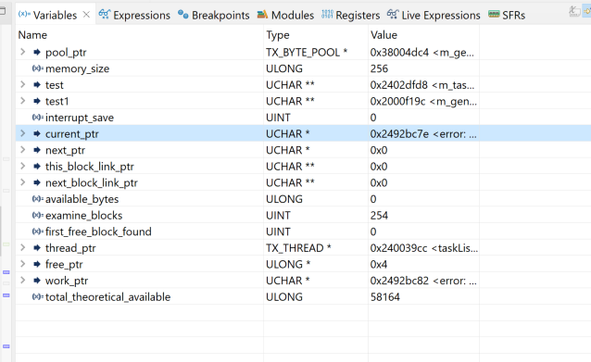

I am having issues with threadX tx_byte_allocate throwing a hard fault exception.
This only happens after some time of byte allocate and release. There are still plenty of available bytes according to the pool. But somehow in _tx_byte_pool_search it encounters some problem.
I am not posting the entire source code here as that will be huge. Anyway, I am using STM32H753. I created a byte pool using DTCRAM (128K).

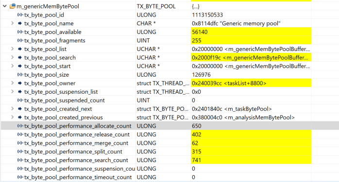

This  is the screenshot of the pool when the hard fault happens. byte pool available is still more than 50k
Below are the local variables during the fault. As you can see current pointer goes to 0x2492bc7e. That memory is not available for H753 and obviously will throw a hard fault error trying to access this memory.
Specifically on line below inside the do while(examine_blocks != ((UINT) 0)) loop
work_ptr = TX_UCHAR_POINTER_ADD(current_ptr, (sizeof(UCHAR *)));
free_ptr = TX_UCHAR_TO_ALIGN_TYPE_POINTER_CONVERT(work_ptr);
if ((*free_ptr) == TX_BYTE_BLOCK_FREE) //<-----------HARD FAULT
Now my question is why? Clearly, I have enough available bytes in the pool. You can also see below that the memory required is only 256 bytes. Even if the memory gets fragmented, I am pretty confident there is a block with 256 bytes free on it. Besides, ThreadX is supposed to merge those splits or fragments. Which is also stated in the pool above (tx_byte_pool_performance_merge_count)

To follow up on this for anyone experiencing it, I have found a more valid explanation as to what is causing this bug as the "Accepted Solution" here doesn't really answer it, and did not solve it for me. It was likely just some voodoo magic timing change to the code operation that fixed it for their particular implementation.
My root cause was having 2 independent threads at different priorities trying to use the same tx_byte_pool_allocate calls on the same shared byte pool at the exact same time. This was because I had written a spoofed malloc/free function that went to these byte pools to claim and free memory.
Digging down into _tx_byte_pool_search shows that whichever thread is calling it is the current owner of the pool. So if you get a priority preemption while a lower thread is allocating memory, it can have the memory it is trying to claim ripped out from under it while it is in the process of claiming it. There is clearly something that is not re-entrant about those functions, which in a way makes sense as the memory is "shared" and hence can't really be re-entrant. But there must still be a bug somewhere in ThreadX where it can't properly gate off the acquired memory pointers from separate threads to ensure they are returned to the proper thread.
The solution that worked for me was to use a Mutex with priority inheritance enabled around the shared tx_byte_allocate calls. The priority inheritance being important because it lets the lower priority thread finish up the allocation request while the higher thread waits. This prevents the hug of death while letting the allocation finish without nulling out that pointer by a higher thread after the lower priority thread had already been assigned a pointer.
