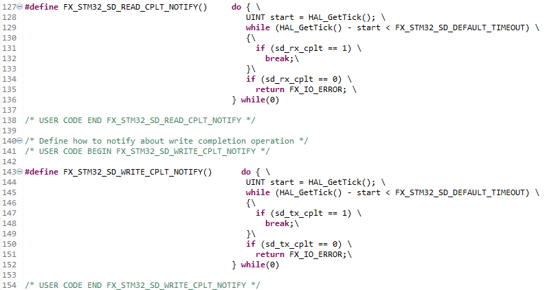

for the "wait for completion" it is not missing :smiling_face_with_smiling_eyes:, it is implemented here.
https://github.com/STMicroelectronics/STM32CubeU5/blob/eb4d106d4ba5bbbc2eb2b0674ef5a3dcd2b3f4bd/Projects/STM32U575I-EV/Applications/FileX/Fx_File_Edit_Standalone/FileX/Target/fx_stm32_sd_driver.h#L127
and here:
https://github.com/STMicroelectronics/STM32CubeU5/blob/eb4d106d4ba5bbbc2eb2b0674ef5a3dcd2b3f4bd/Projects/STM32U575I-EV/Applications/FileX/Fx_File_Edit_Standalone/FileX/Target/fx_stm32_sd_driver.h#L143
so maybe the default timeout should be increased, after lowering the SD Clock?
regards
Haithem.

BUT in my fx_stm32_sd_driver.h, I have rather this code:
/* Define how to notify about Read completion operation */
#define FX_STM32_SD_READ_CPLT_NOTIFY()
So why did CubeMX not generate the code to wait?

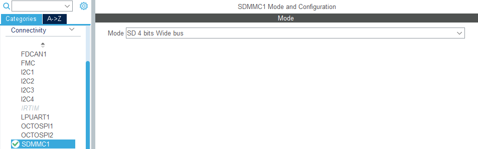

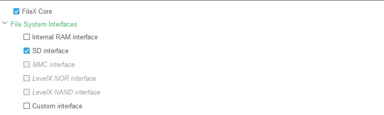

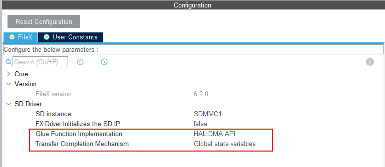

going to check with lower SDMMC Clocking. Meanwhile I checked the using STM32CubeMX 6.8.0 and the code is correctly generated. Below are screenshot of the configuration steps.
  • Enable SDMMC 4-bits wide config.
  • Select FileX MW and select SD interface.
  • In the configuration panel select the " HAL DMA API" & "Global state variables" for respectively "Glue function Implementation" & "Transfer Completion Mechanism"
  • After code generation Check the fx_stm32_driver.h file and the macros are there.
