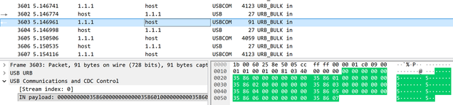

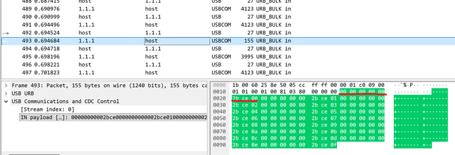

To get the issue to occur, I put a small delay after polling. This lets the internal buffer fill up. When this happens, I see a packet loss of a multiple of 64 bytes. Here's an example:
Received 1134464 bytes over the last 1 second (9.08 Mbps) (n=154, minread=3968, maxread=16384)
dropped 128 bytes of data (values 0x2BCE00-0x2BCE0F)
Received 1146752 bytes over the last 1 second (9.17 Mbps) (n=146, minread=4096, maxread=16384)
dropped 64 bytes of data (values 0x358600-0x358607)
Received 1134528 bytes over the last 1 second (9.08 Mbps) (n=146, minread=4096, maxread=16384)
The data loss as a percentage is around 0.01% which makes it hard to find if you're not expecting it.

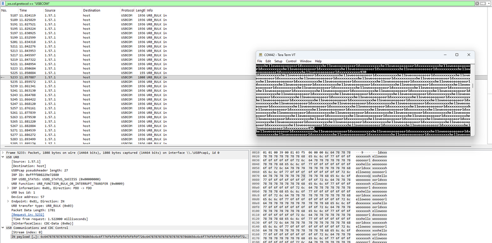

I'm also using WireShark to capture the USB packets as they're received. Looking at these, I can see the packet with 0x2BCE00 was received by the PC but never made it to the Python serial port interface. In this case, the missing packet had 128 bytes of payload and they were all missed.
In other cases, only 64 bytes were lost. Always a multiple of 64 bytes.

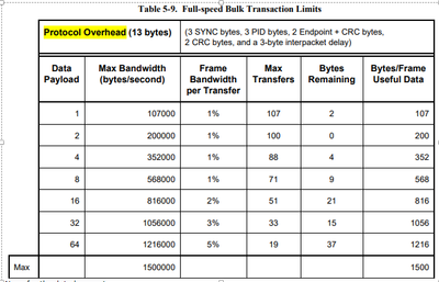

>It would be interesting to know the theoretical maximum speed after all required USB overhead.
According to the USB 2.0 protocol documentation from usb.org, the maximum achievable throughput, after excluding overhead packets, is 1,216,000 bytes per second, which is equivalent to 9.72 Mbps. However, achieving this throughput requires a clean hardware and software implementation.

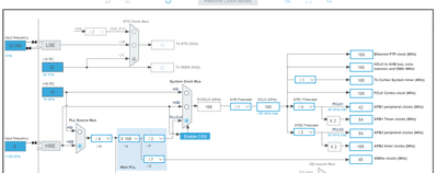

>The bus speed of USB FS is 12MHz.
can you please provide more details about the choice of 12 MHz, as the reference manual recommends providing at least 30Mhz for USB HS and 14.2Mhz for USB FS
I'm referring to the USB FS clock speed and signaling rate which is 12 MHz. The AHB speed I'm using is whatever default is set by CubeMX.

I can confirm the reported behavior. I detected packet loss (part of the transferred buffer is missing) in one of the transmissions as you can see in the caption attached below a buffer that lacks ~60bytes was transmitted with success status, but this only occurs during high baud rate transfers (above 8 Mbps). No packet loss is recorded at lower baud rates.
Further investigations will be conducted with our experts.
For now, you can insert delays in the code to reduce the baud rate below 8 Mbit/s. This approach ensures efficient throughput with zero packet loss because it reduces the load on the USB controller.
