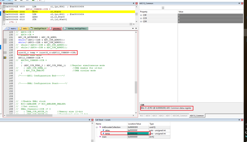

Incorrect readings ADC12_COMMON register
mJar
Tests STM Studio Ide and microcontroller from the stm32G474 series. The debugger incorrectly reads the ADC12_COMMON register values. When I read the registers into the variable, everything is ok, it's correctly set. I attach a photo.

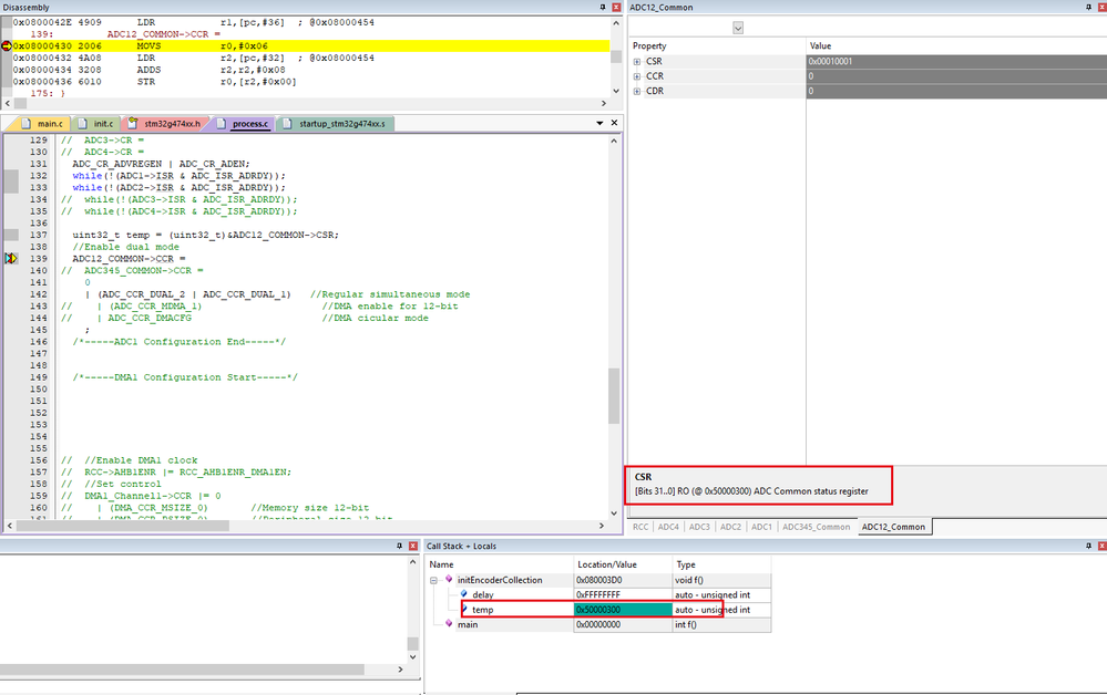

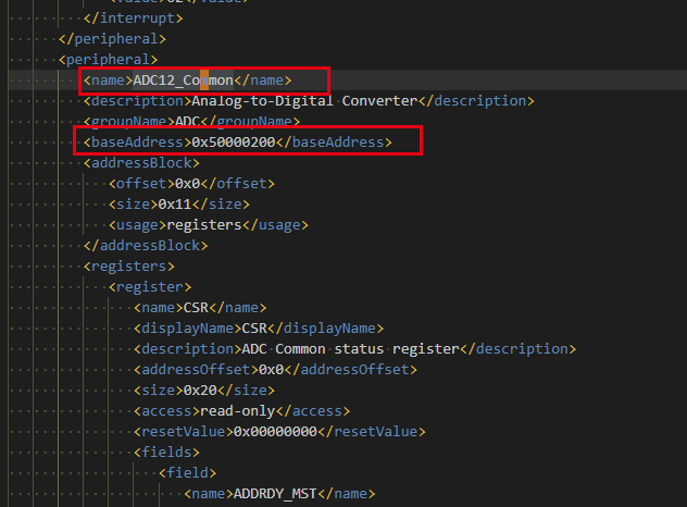

Yes, I found this problem too, with STM32G474 in keil, I figured that the register in peripheral debug window​ was cofigured with wrong base address 0x50000200, but the actual value is 0x50000300, I think it's a bug in keil package which ST offered to MDK. Hope solved this problem.
Zheng Liang
Finally, I found the source of the bug, it's in a STM32G474xx.svd fild, then I regenerate sfr file base on http://www.keil.com/support/man/docs/uv4/uv4_ut_svdconv.htm
Here is the snapshot of bug and fixed test.
I upload these files in zip package, you can download and cover your same file in keil, my path is: C:\Keil_v5\ARM\PACK\Keil\STM32G4xx_DFP\1.1.0\CMSIS. Hope it could help you.

Amel NASRI
Please note that this error in STM32G4 svd files is reported internally.
Corrective action will be taken on this regard.
Thanks for bringing it to our attention.
