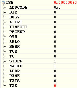

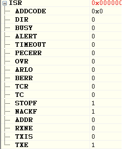

‎2020-02-10 10:16 PM
I did two snapshots - before LL_I2C_TransmitData8(I2Cx, address); and after. The only difference TXE bit.
‎2020-02-10 11:34 PM
STOPF=1 and NACKF=1, what do you think is it OK?
