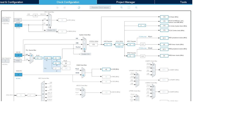

I'm currently implementing very low current measurement electronics, such as Femto Amps.
To do this, I'm using the STM32G431CBU MCU. I'm acquiring the output voltages of a float voltage transimpetance amplifier, and I'm taking a running average.
My MCU is clocked by a 24 MHz quartz crystal, with the instruction frequency set to its maximum of 170 MHz.
But my function is still slow, between 24 µs and 50 µs.
