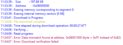

I am programming a custom board using STM32L562. While trying to connect the debugger using STM32CubeIDE I get the following error:
Verifying ...
Error: Data mismatch found at address 0x08001000 (byte = 0xFF instead of 0x0E)
Error: Download verification failed
Encountered Error when opening C:\ST\STM32CubeIDE_1.13.1\STM32CubeIDE\plugins\com.st.stm32cube.ide.mcu.externaltools.cubeprogrammer.win32_2.1.0.202305091550\tools\bin\STM32_Programmer_CLI.exe
Error in STM32CubeProgrammer
Shutting down...
Exit.
Besides, when I am trying to erase the memory with the programmer it is impossible.
Does anybody have any suggestion?

This looks to my like erase flash. Di programming succeed?
It says file download complete. Then tries to read and finds the memory mismatch.
Give context, like:
- Commercial board or own construction?
- Did it work before?
- What options are set?
- Running in secure mode?

Indeed this is solved by doing full chip erase before programming. In my case, full chip erase was not possible because of option bytes settings. When I allowed erasing the specific parts of memory it worked.
@Tesla DeLorean wrote:
Avoid Hubs and Docking Stations with ST-LINK/V2, use direct, high quality data cable.
This worked for me. I was using USB HUB. Still I do not understand why, because the programmer app could detect and erase flash. The IDE could download it but during verification, it showed error.
