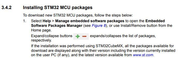

I have installed STM32CubeIDE on Ubuntu 20.04 and set a project for NUCLEO L552ZE-Q, i want to try examples of STM32L5, and found that it need STM32CubeL5. How to install it ?

Hello @MQi.1​ ,
You can download the STM32CubeL5 MCU package from STM32CubeMX (integrated with STM32CubeIDE tool) in command-line mode, or using user interface.
You can follow the instruction in the UM1718:

I found STM32CubeL5 Firmware Package V1.3.0 / 26-June-2020 has already installed in my STM32CubeIDE, bu how to new a project based on it?
MQi.1
Senior II
Sorry for such a silly question, I found it "Example selector" besides "Board selector".
