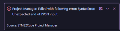

I'm trying out the new STM32CubeIDE extensions for VSCode and have generated a CMake project using CubeMX. I'm unable to setup my project as I get this error:
I don't know what JSON file it is referring to as there are none in my project except the auto-generated CMakePresets.json, but I don't think that's the issue since I get the same error even if I remove that file.
I have tried to re-install the extensions and restart VSCode with no luck.

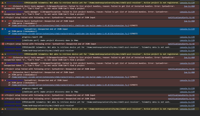

Could you please open the Developer Tools window (Help > Toggle Developer Tools), switch to the Console tab, and record any errors shown when running your scenario?
Here is a screenshot of the console output. Right now I'm working in WSL, but I have observed the same issue directly in Windows.
Julien D
It looks like the extension is unable to fetch the list of available bundles from the remote because the received JSON file, which describes the registry content, has an invalid format.

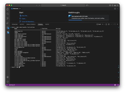

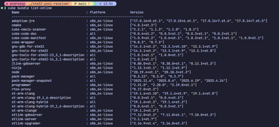

Can you reproduce this failure using the cube bundle list-online command in the VSCode integrated terminal?
Normally you should have:
andreasp00
The command gives no errors and seem to work fine:
