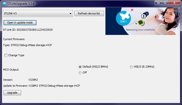

Check, if your system clock is set as you expect it to be - e.g. output it to MCO pin and observe using oscilloscope/LA.
Users often incorrectly set the primary clock source's frequency (crystal frequency), so check that too. I don't use Cube/HAL, so I don't know the name and placement of the related constant which tells Cube/HAL the HSE input frequency.
@Community member @TDK #25MHz_vs_8MHz
2021-10-19 09:27 AM
The ZI2 uses an ST-LINK/V3 so extra chances of odd clock speed settings. V3 now configurable to a broader selection of unhelpful frequencies. Don't see this well documented, but offered via the update application as I recall.
HSE_VALUE is usally defined in stm32h7xx_hal_conf.h
The NUCLEO-H743 comes in two forms, ie ZI and ZI2, there is some different pins usage, so command line define needs to be set appropriately.
See USE_NUCLEO_H743ZI2
STM32Cube_FW_H7_V1.8.0\Drivers\BSP\STM32H7xx_Nucleo\stm32h7xx_nucleo.h
