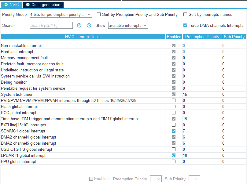

2022-04-11 02:25 PM
Do these interrupt priorities seem reasonable?
NVIC Interrupt Table Enabled Preemption Priority Sub Priority
Non maskable interrupt TRUE 0 0
Hard fault interrupt TRUE 0 0
Memory management fault TRUE 0 0
Prefetch fault, memory access fault TRUE 0 0
Undefined instruction or illegal state TRUE 0 0
System service call via SWI instruction TRUE 0 0
Debug monitor TRUE 0 0
Pendable request for system service TRUE 0 0
System tick timer TRUE 15 0
PVD/PVM1/PVM2/PVM3/PVM4 interrupts through EXTI lines 16/35/36/37/38 FALSE 0 0
Flash global interrupt FALSE 0 0
RCC global interrupt FALSE 0 0
Time base: TIM1 trigger and commutation interrupts and TIM17 global interrupt TRUE 15 0
EXTI line[15:10] interrupts FALSE 0 0
SDMMC1 global interrupt TRUE 7 0
DMA2 channel4 global interrupt TRUE 6 0
DMA2 channel5 global interrupt TRUE 6 0
USB OTG FS global interrupt FALSE 0 0
LPUART1 global interrupt TRUE 10 0
FPU global interrupt FALSE 0 0
In case that's too hard to read:
2022-04-11 02:50 PM
Look to be reasonable.
