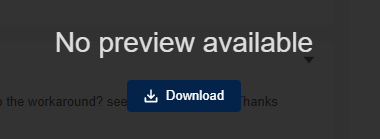

2022-08-19 03:37 AM
could you please repost the link to the workaround? seems like its broken. Thanks
Great detective work btw!

2022-08-19 11:32 PM
Cube_FatFs_uSD_DMA_RTOS_1DMA? I just tried clicking on it and it gave me this:
and when I clicked "Download" I got Cube_FatFs_uSD_DMA_RTOS_1DMA.zip, which seems to be complete. Maybe there is a permissions problem?
2022-08-22 01:10 AM
Hi, thanks, the link to your example still worked. I was more interested in STMs direct reply to your case.
