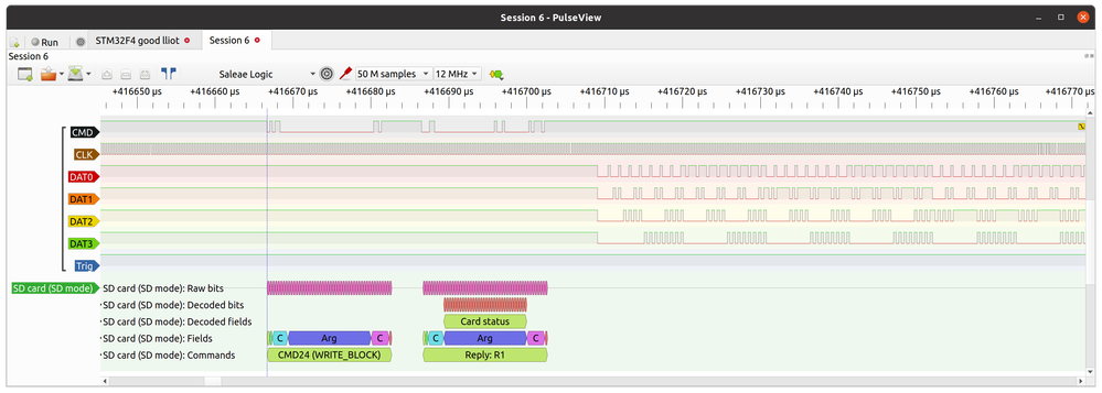

I'm trying to get FatFS working on SDMMC, with DMA, and having problems.
First, the bundled version of FatFS seems to be ancient. It is so old that it doesn't resemble the documented API at http://elm-chan.org/fsw/ff/00index_e.html. Is there a way I can update it such that my changes won't be wiped out each time I run or update the Device Configuration tool?
The big problem is that it won't work if I select "Use dma template" in Device Configuration Tool/Pinout & Configuration/FATFS/Advanced Settings. If I disable "Use dma template", it works OK (with polling).
With DMA enabled, it gets hung up here:
SD_write() at sd_diskio.c:351 0x80081c8

I'm still trying to get this working. For now, I've disabled FatFS in the Device Configuration Tool and I'm just trying to work at the HAL level.
First, initialization:
 	HAL_StatusTypeDef hal_rc = HAL_SD_Init(&hsd1);
 	if (hal_rc != HAL_OK)
		return RES_ERROR;
	/* Configure SD Bus width (4 bits mode selected) */
	/* Enable wide operation */
	if (HAL_SD_ConfigWideBusOperation(&hsd1, SDMMC_BUS_WIDE_4B) != HAL_OK)
		return RES_ERROR;
Next, to write a block to the SD card:
assert(0 == ((uintptr_t )buff & 0x3)); // Check for WORD alignment for DMA
	if (HAL_SD_WriteBlocks_DMA(&hsd1, (uint8_t*) buff, sector, count) != HAL_OK) {
		return RES_ERROR;
At this point I would expect a `HAL_SD_TxCpltCallback` but it never comes.
`HAL_DMA_GetState` just returns HAL_DMA_STATE_BUSY forever.
In hsd1, DLEN and DCOUNT are both 512 (the block size).
DCTRL is Binary:10011001
STA is Binary:100000101000000000000.
MASK is Binary:11010.
In hsd1.hdmatx,
CCR: Binary:10101010011011
CNDTR: Decimal:128 (Hex:0x80)
If I'm reading this right, DCTRL says:
  • DTEN: Data transfer enabled bit: enabled
  • DMAEN: DMA enable bit: enabled
  • DBLOCKSIZE: Data block size: 512 bytes
DMA CCR says:
  • PL[1:0]: priority level: high
  • MSIZE[1:0]: memory size: 32 bits
  • PSIZE[1:0]: peripheral size: 32 bits
  • MINC: memory increment mode: enabled
  • PINC: peripheral increment mode: disabled
  • CIRC: circular mode: disabled
  • DIR: data transfer direction: read from memory
  • TEIE: transfer error interrupt enable: enabled
  • HTIE: half transfer interrupt enable: disabled
  • TCIE: transfer complete interrupt enable: enabled
  • EN: channel enable: enabled
Why isn't my transfer completing?

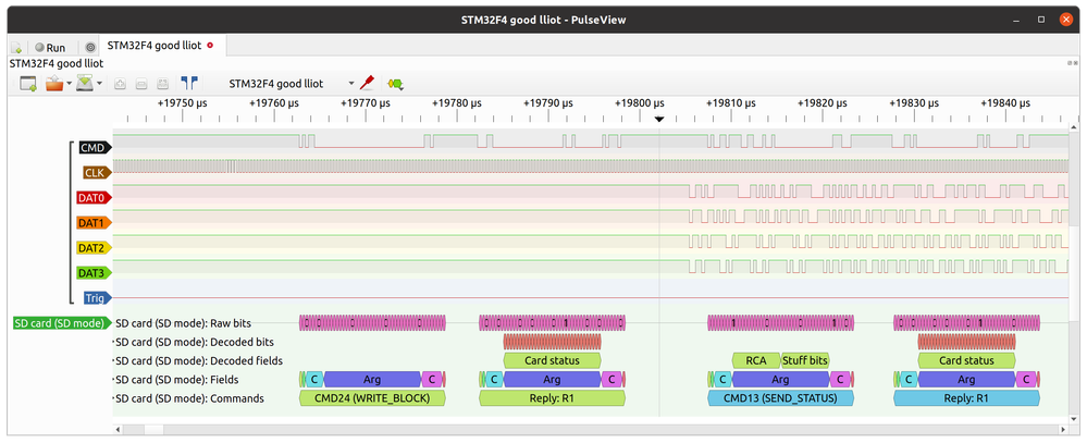

I can read successfully with DMA, but not write. I.e., HAL_SD_ReadBlocks_DMA works, but HAL_SD_WriteBlocks_DMA does not. If I write with HAL_SD_WriteBlocks and read the data back with HAL_SD_ReadBlocks_DMA, it works, as shown in the attached test case. It produces the following output:
test:152: SD Card State:Card is in transfer state
test:172: SD Card State:Card is in programming state
test:172: SD Card State:Card is in transfer state
test:184: DMA State:DMA initialized and ready for use
test:188: SD Card State:Card is in transfer state
 Read data matched.

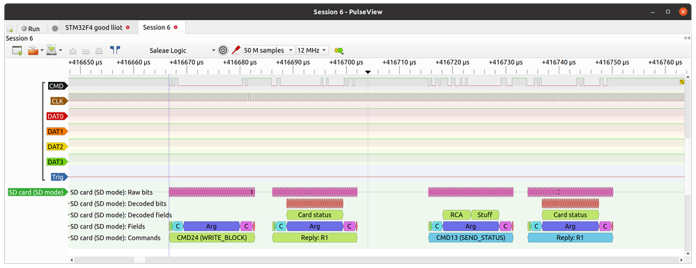

I modified my test case to use HAL_SD_WriteBlocks_DMA. I added some code to print out the SDMMC and DMA registers before and after the call. Here is the output:
test:185: Starting
test:201: SD Card State: Card is in transfer state
test:219: SDMMC registers:
                    3         2         1         0
                   10987654321098765432109876543210
        POWER  : 0b00000000000000000000000000000011
        CLKCR  : 0b00000000000000000100100100000001
        ARG    : 0b11100110001001000000000000000000
        CMD    : 0b00000000000000000000010001001101
        RESPCMD: 0b00000000000000000000000000001101
        RESP1  : 0b00000000000000000000100100000000
        RESP2  : 0b01011011010110010000000000000000
        RESP3  : 0b01110110101100100111111110000000
        RESP4  : 0b00001010010000000100000000010010
        DTIMER : 0b11111111111111111111111111111111
        DLEN   : 0b00000000000000000000000000001000
        DCTRL  : 0b00000000000000000000000000110011
        DCOUNT : 0b00000000000000000000000000000000
        STA    : 0b00000000000000000000000000000000
        ICR    : 0b00000000000000000000000000000000
        MASK   : 0b00000000000000000000000000000000
        FIFOCNT: 0b00000000000000000000000000000000
        FIFO   : 0b00000011100000000011010100000010
test:221: TX DMA State: DMA initialized and ready for use
test:223: TX DMA registers:
                    3         2         1         0
        CCR    : 0b00000000000000000011101010010000
        CNDTR  : 0b00000000000000000000000000000000
        CPAR   : 0b00000000000000000000000000000000
        CMAR   : 0b00000000000000000000000000000000
test:226: Writing
test:233: SDMMC registers:
                    3         2         1         0
        ARG    : 0b00000000000000000000000000000000
        CMD    : 0b00000000000000000000010001011000
        RESPCMD: 0b00000000000000000000000000011000
        DLEN   : 0b00000000000000000000001000000000
        DCTRL  : 0b00000000000000000000000010011001
        DCOUNT : 0b00000000000000000000001000000000
        STA    : 0b00000000000101000101000000000000
        MASK   : 0b00000000000000000000000000011010
        FIFOCNT: 0b00000000000000000000000010000000
        FIFO   : 0b00000011000000100000000100000000
test:236: TX DMA State: DMA process is ongoing
test:238: TX DMA registers:
                    3         2         1         0
        CCR    : 0b00000000000000000011101010011011
        CNDTR  : 0b00000000000000000000000010000000
        CPAR   : 0b01000000000000010010100010000000
        CMAR   : 0b00100000000001001111011111001100
test:245: SD Card State: Card is receiving operation information

On the NUCLEO-F413ZH, here's what I see with a logic analyzer on the SD bus when I call HAL_SD_WriteBlocks_DMA:
0693W00000LxcmFQAR.pngOn the NUCLEO-L4A6ZG, here's what I see with a logic analyzer on the SD bus when I call HAL_SD_WriteBlocks_DMA:
0693W00000LxcsmQAB.pngThere is no activity at all on the data lines!
Now, again on NUCLEO-L4A6ZG, if I simply change HAL_SD_WriteBlocks_DMA to HAL_SD_WriteBlocks, I get this:
0693W00000LxcuiQAB.pngSo, when I call HAL_SD_WriteBlocks_DMA on the L4A6ZG, the command is sent but no data is ever sent.
