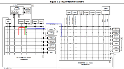

Hi @embeddedGeek,
Looking at the STM32H745XX datasheet https://www.st.com/resource/en/datasheet/stm32h745zg.pdf
you can find the bus matrix description in the page 30.
As you can notice above SDMMC1/DMA does not have access to the Domain2 SRAMx memories as it is not connected to the D1/D2 AHB bus. it can only access the AXI SRAM in D1, same applies for SDMMC2 in the D2 that can't access the AXI SRAM in D1 but only the SRAM1, SRAM2 and SRAM3.
So to use DMA within SDMMC either work with CM7 & SDMMC1 or CM4 & SDMMC2.
otherwise you'll need to use polling mode.

U mean Internal DMA of SDMMC or MDMA. What if i use AXI RAM for DMA and access with M4 to AXI RAM via ART by using D2-to-D1 AHB. I believe some trick could be done here to have multi core access to SDMMC1
‎2023-11-06 3:26 AM - edited ‎2023-11-06 3:32 AM
My ultimate goal is access SDMMC1 via both cores and solve abritarition with Hardware semaphores. I done it with bare metal system. But when It comes using freertos, CubeMX forces me to enable use dma template for fatfs. Thats makes SDMMC unaccessiable. But when i copy polling api sd_diskio.c files over my old files and suspend scheduler, i can access SDMMC from M4 again. But suspending scheduler is not desirable for my application. I wonder if there is any work around of this.
Also there is some flags for MDMA triggers. I wonder if i can use those to transfer data from AXI RAM to d2 rams to make it like working on D1 but copying some data(structures of fatfs, hal_sd and real data) to D2 rams. SO m4 can have pseudo access by triggering MDMA?
Also if use dma template not viable for m4 when accesing sdmmc1, when its there on cubemx. Thats should be a bug then?
