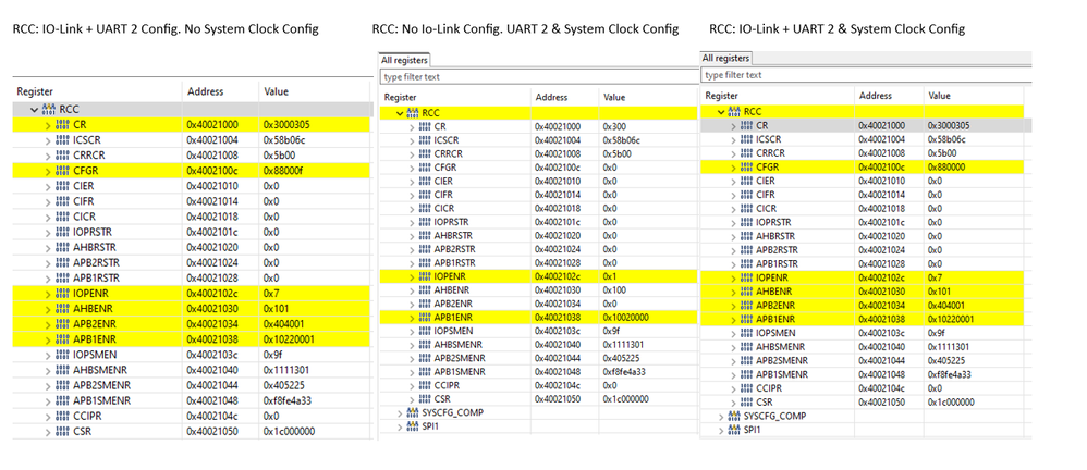

I am developing a IO-Link device and I am using the P-NUCLEO-IOD01A kit demo. The IO-Link works fine. Now I need to use a serial communication to receive a frame from another device. For this I use USART2. I use the example "UART_HyperTerminal_TxPolling_RxIT" and I've implemented the code in the P_NUCLEO_IOD01A1_Demo_Lib project (Io-Link project/example). IO-Link communication uses USART1.
The USART2 example just configures the uart and the System Clock. The clock setup is done by the function "SystemClock_Config();", please below. This function overwrite the RCC register values configured by the IO-Link function "stack_init();". In fact, they overwrites each other depending on the order I put both functions in my code. If I initialize first the "stack_init();" and then the "SystemClock_Config();", UART2 works fine but IO-Link doesn't and vice versa.
I don't have access to the internal functions of "stack_init();" due is a limited example.
I think USART1 uses the PLL and USART2 uses the MSI clock.
I've tried to use the same clock for UART2 than IO-Link USART1, but it doesn't work. The baud rate for USART2 is updated according to the clock setup, but there is something more that I can't see because I am not very familiarized with STM32 MCU.
The problem is when is called the function "HAL_RCC_ClockConfig(&RCC_ClkInitStruct, FLASH_LATENCY_0)!" in the "SystemClock_Config();". I think there is some registers that are not configured correctly due to the overwrite, but after several configuration I can't fix the problem.
Please, refer to the three files of internal MCU registers and to the RCC comparison tables:
  1. CPU_REG_YES_IO-Link_Config_YES_UART2_Configuration_and_NO_SystemClockConfig.txt
    1. Here the IO-Link works fine.
    2. UART2 doesn't work. I can't receive the UID from the reader.
  2. CPU_REG_NO_IO-Link_Config_YES_UART2_Configuration_and_YES_SystemClockConfig.txt
    1. Here the UART2 works fine and I can receive the UID from the reader.
    2. IO-Link doesn't work.
  3. CPU_REG_YES_IO-Link_Config_YES_UART2_Configuration_and_YES_SystemClockConfig.txt
Please, can anybody help me with this?
Thanks.
Joaquim.
