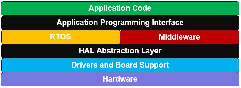

Roman Jasmann
@henry.dick​
You are talking about a hardware abstraction layer (ST's cube HAL is not a real abstraction layer). I'm not asking about HAL APIs, but which approach (CMSIS vs LL) people use in order to implement a HAL. A good software architecture always has got a HAL for the middleware (and application layers). However, in the end each HAL uses either direct register access (by CMSIS), something like ST's cube HAL, or the LL APIs.
0690X000006BzXRQA0.jpghttps://www.beningo.com/embedded-basics-apis-vs-hals/
waclawek.jan
... and I thought you are genuinely interested.
