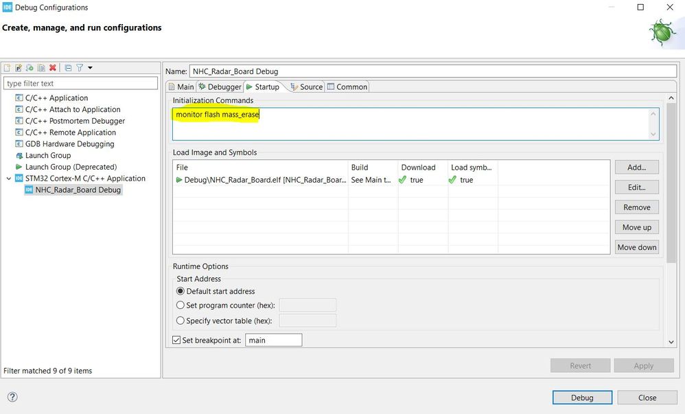

‎2019-12-04 3:36 AM
There are a few ways of doing it. For example, you can either call cube programmer CLI and run a mass erase as a pre-build step ${cubeide_cubeprogrammer_path}/STM32_Programmer_CLI.exe
If you use that way it's important that in the debug configuration under "Main" tab that you don't have auto build disabled because then the pre-build step will not be called.
You can also go to the startup tab in the debug configuration and add "monitor flash mass_erase" as an Initialization command.

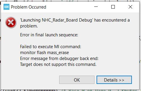

‎2021-11-06 10:19 AM
I think this works for a ST link debugger connection ; unfortunately not for a Segger Jlink?!
When adding "monitor flash mass_erase" to the debug configuration -> Initialization startup :
I get the following error :
Any suggestions?
diederik
‎2021-11-08 2:06 AM
Hello Diederik,
J-Link has its own commands which you can find more about in their user manual available here.
I believe the command for J-Link should be flash erase but you can double check that with the manual.
‎2022-03-14 4:52 AM
Using Segger J-Link the command is: monitor flash erase
‎2022-03-15 3:10 AM
Thank you for the clarification! I usually use my ST-Link so I wasn't sure :grinning_face_with_sweat:
