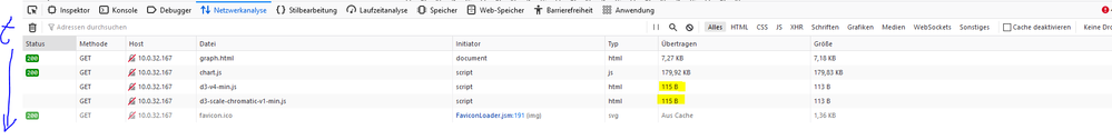

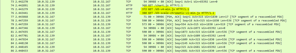

When the client requests 3 rather large files successively, the Rx ETH buffers get corrupted. In this example, the resource chart.js is transferred successfully (see below network trace). The data directly following this request can not be properly sent back from the server. They should be in the *** kB range, however my server can't interpret the HTTP query and sends back a error message (~100B).
This is a more detailed view with Wireshark. The transmission for the first resource (chart.js) works (on port 30986 here):

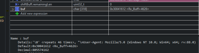

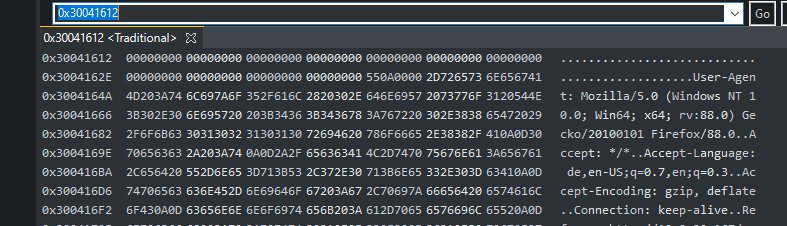

The other following GET's fail. Further investigation shows, that the begin of the HTTP request line and some header fields are overwritten with 0's. This is unprocessed data directly out of the LwIP stack:
_legacyfs_online_stmicro_images_0693W00000BaNMH.pngThe rest of the frame is ok and has valid data. This phenomenon never occurred to me before:

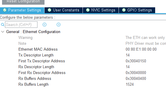

The ETH hardware is configured like this:

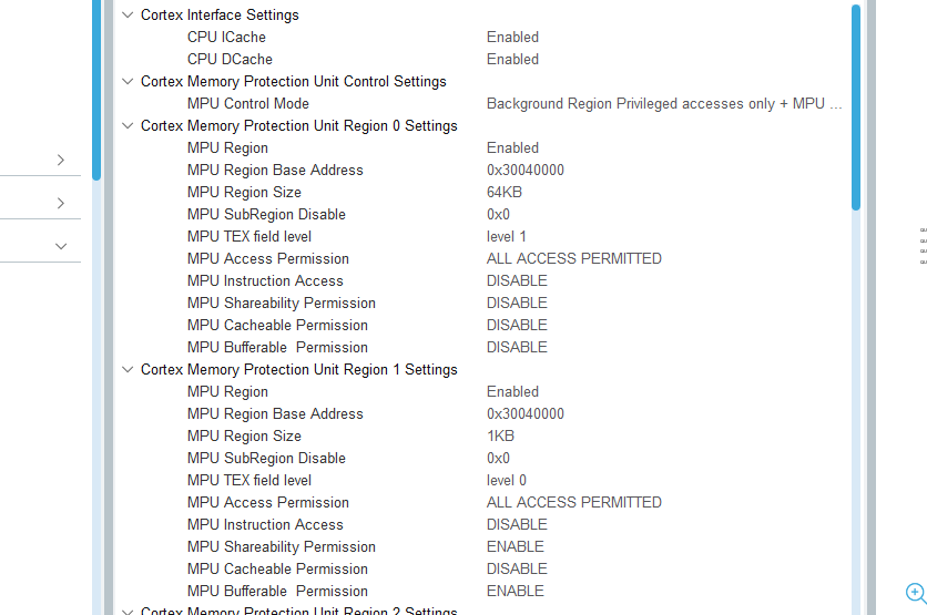

_legacyfs_online_stmicro_images_0693W00000ANNiM.pngThe MPU treats the Rx-Buffers as Strongly ordered, and the Rx+Tx descriptors as Device Memory:

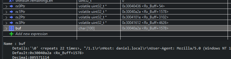

_legacyfs_online_stmicro_images_0693W00000BaNeG.pngHere is the snippet, where "buf" from above was inspected, with a breakpoint in line 10:
recv_err = netconn_recv(conn, &inbuf);
if(recv_err != ERR_OK)
    webservState = WEBS_NETWORK_ERR;
    break;
netbuf_data(inbuf, (void*)&buf, (u16_t*)&buflen);
webservState = WEBS_HANDLE_FILLING;
break;

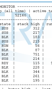

I tried out using the hook function you mentioned, however I did not observe any unusual behavior. In fact we already implemented a basic monitoring function, that uses FreeRTOS functions to read out the stack high watermark. According to those numbers everything is OK as well:

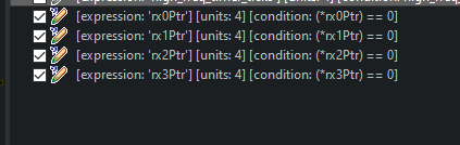

I also enabled Watchpoints on the first 4 Bytes of the TCP payload (within the Rx Buffers). However, I never stepped into the problematic regions:
extern uint8_t Rx_Buff[ETH_RX_DESC_CNT][ETH_RX_BUFFER_SIZE];
volatile uint32_t* rx0Ptr = (uint32_t*)&Rx_Buff[0][54];
volatile uint32_t* rx1Ptr = (uint32_t*)&Rx_Buff[1][54];
volatile uint32_t* rx2Ptr = (uint32_t*)&Rx_Buff[2][54];
volatile uint32_t* rx3Ptr = (uint32_t*)&Rx_Buff[3][54];
0693W00000BarRXQAZ.pngWith these settings, the data breakpoint did not seem to fire. I set a instruction breakpoint where I first encountered the problem, and ran into the same issues, without previously stepping to where the actual 0 write happened:
0693W00000BarUyQAJ.pngIs it possible that the problematic write could occur during streaming of the RX DMA, and that in that timeframe, the processor can't evaluate the data breakpoint?
