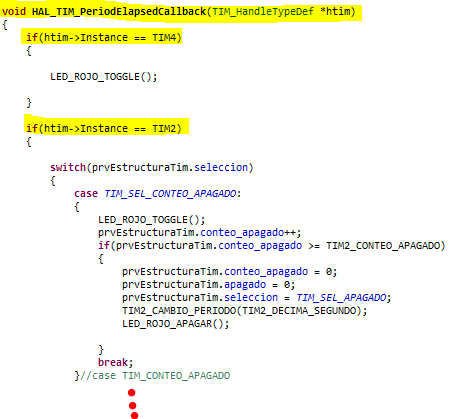

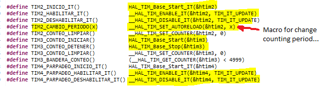

‌, based in the needes I would suggest to you the following if you are using HAL and CubeMX:
* Define in your program the periods that need to be counting at same time, I´m quite sure that there are instants where all 8 timers don't need to be counting at same time.
* Set all the timers with an initial period, enable all interruptions, set all in freerun mode, be sure that preescaler value is able to handle required times, and set different priorities for each timer.
* As programming
recommendation
, set macros to enable and disable interrupts, start and stop timers and change counting periods, there is an example of one code I made:
* In the main loop set the periods and the timers in the moment that are needed, enable the timers interrupts and start the counting.
* Using the HAL you must to take on count that there is just one function to handle all timers callbacks, so you must to check from which timer comes the interrruption with some like this:
* You should disable some interruptions to avoid that could be called meanwhile the interruption function is in execution.
* In order to check not only from which timer come the interrupt, you should declare a global flag to know which task is in execution (In the case that you are setting a timer with different periods).
* Don't make long codes in the callback function, instead set or clear flags that could be related in the main loop, I suggest to do the main loop as a state machine, if you make the state machine diagram of all your code you could see clearly where you have to set and start the timers.
Not sure if that could help to you, but works for me. Thanks
