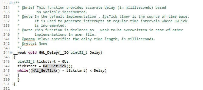

The HAL_Delay() function uses the software incremented counter provided by SysTick or another timer calling HAL_IncTick. Something has to call it. A far safer method would be for HAL_Delay() to use the TIMx->CNT value of a hardware TIM ticking at 1us or 1ms across a 32-bit time line, not one repeatedly interrupting on a more frequent basis.

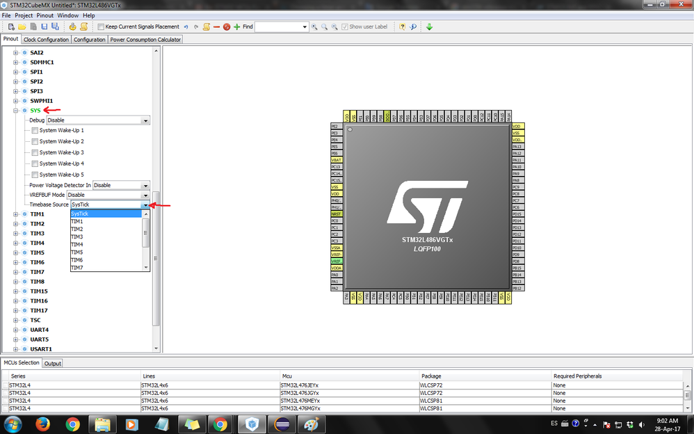

When you make a source code for the microcontrollers, there are functions that need a time parameter for its proper operation, for example for communication peripherals as UART or SPI, you have to select a timeout value for a Tx/Rx transactions when you work on polling mode, those time values are controlled by the all the functions related to SysTick. By default, in the CubeMX the SysTick is generated by a dedicated SysTick Timer that configured correctly give the 1ms base time.
If you want to use another source for the SysTick you can choose any other Timer for this, when you choose the timer it won't be able for any other function (as free counting, pwm, etc), this could be set on CubeMX as you can see in the attached image.
 If you want to use the SysTick as time base for make any action, you can use the HAL SysTick functions, one example of how to use those is the HAL_Delay() function:
When you catch the present value of the HAL_Tick, and then you keep comparing until the present value minus the start value be less of the delay time configured.

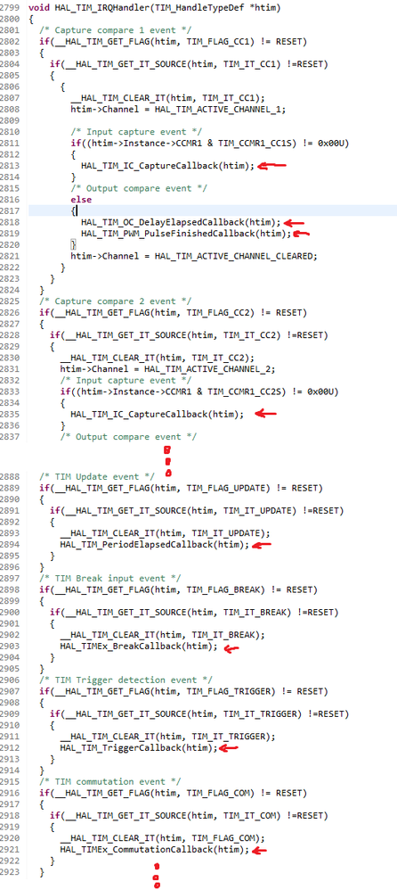

is only a unique ISR for time base interruption for TIM6 a TIM7 thats is because those timers don't have any others interrupt sources as the TIM1 to TIM5. If you prove to use other timer there will be the callback functions for OutputCompare, InputCapture, PWM and of course the Period Ellapsed.
This IRQ code is for the TIM3:

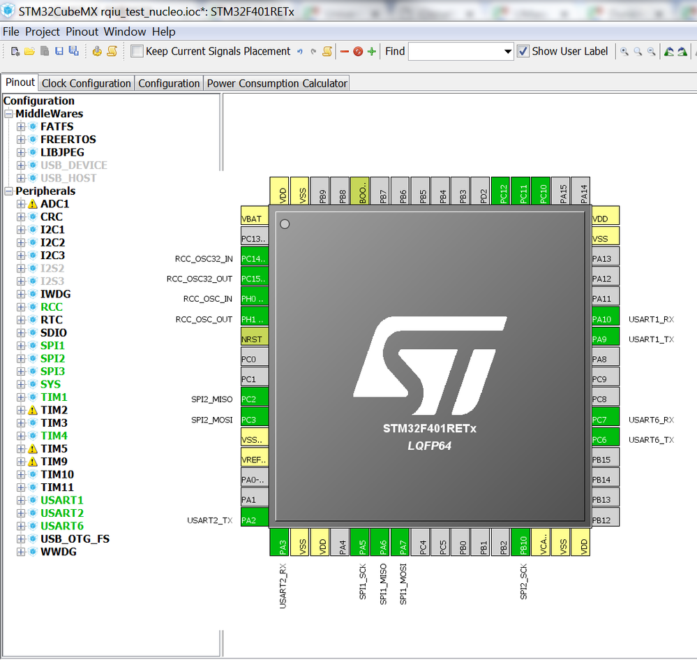

Dear Sir/Madam:
I just found that I have similar problems.  there are limit timers . timer 1, timer9 and timer10 are different from other timers. I have used timer2, timer3, timer4, and timer5 and their interrupts . to each timer, I use internal clock ,
once timers expire, they will create interrupt. My questions are
1. each timer , I only use one channel, there are more channels available, but I want their periods are different,
in my understanding, if you use multiple channels from one timer, their period have to be the same?
if not same, how could I do that? and how could I enable or disable each channel to separate them?
2. if above 1 does not work for multiple channels from one timer, I try to use different timer for each event,
but I found that I could not make  timer1, timer9 and timer10 work for their interrupt
I could only make timer2, timer3, timer4 and timer5 interrupts work.
