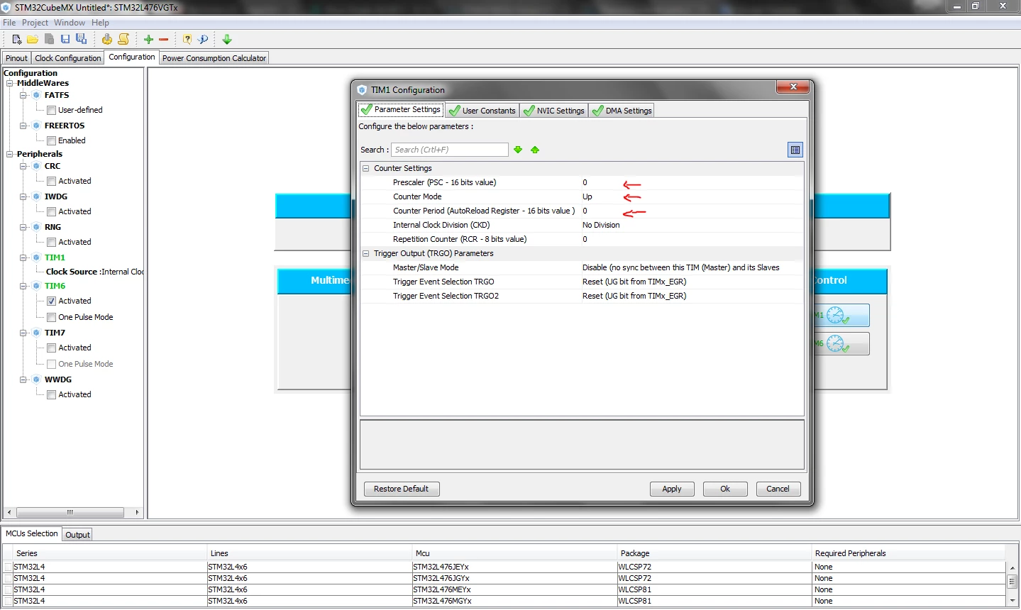

I'm using HAL_TIM library for my timer proposal. I would like to count 100 us. My idea is starting to run a MCU timer in free run mode and having and interruption every this timer period. I have read there are several timers in my st used (stm32L476), and every timer has 3 or 4 channels: pwm, output mode, input capture, compare, etc.. But I don't know which will be the best for my proposal. I guess I can discard PWM modes or input capture mode, cause I only want to be internally counting time being passed, I don't want to be outputing any signal or reading an input pin.
Which is the channel or mode I must choose in order to have an interruption every 100us, 10us, or Xus? (of course I know I must handle the interruptions by sw but first I need to count period in the correct channel/mode)

You don't need any channels to get a periodic interrupt.
Set the Prescaler to clock the TIM at 1 MHz, set the Period to 100-1, enable the Update interrupt, and you'll get an interrupt every 100us
Depending on the APB clock, but Prescaler = (SystemCoreClock / 1000000) - 1   ie figure source divided by 1 MHz to get divisor for 1 MHz
If you run the TIM with maximal period, you can use and advance the channel triggers by 100 at each interrupt for similar effect, but it is more labour intensive.

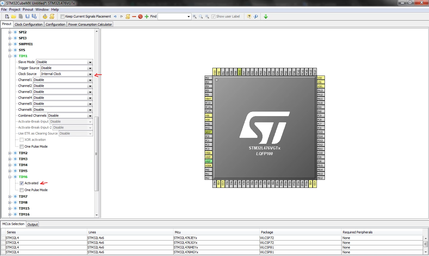

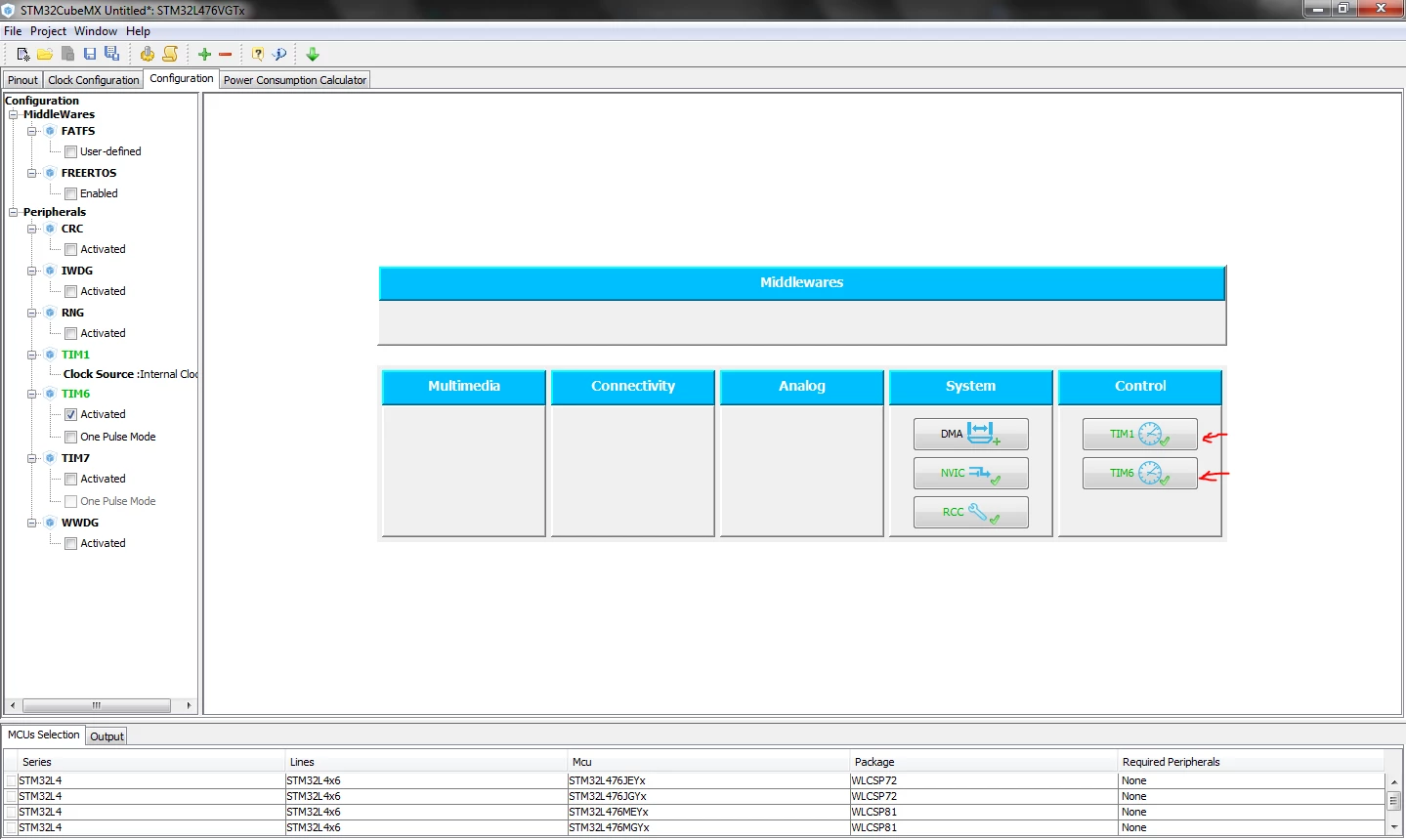

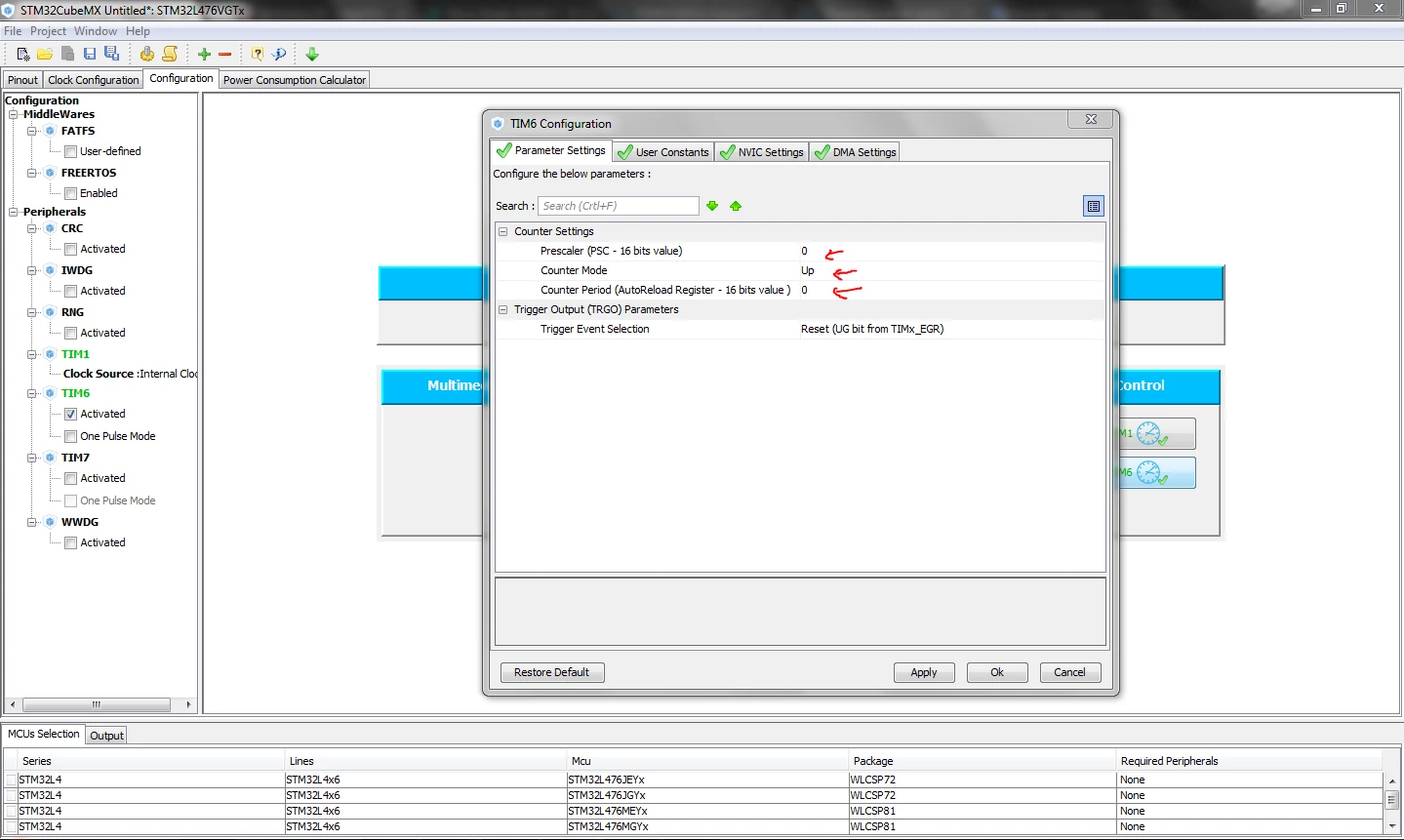

Elkin Granados
April 19, 2017
Posted on April 19, 2017 at 18:07
Hi Eugenia,
The STM32 microcontrollers family have different timers with different features, but all of those with the basic feature of free counting. If you're using the STCubeMX software, in the pinout tab you can see the features of each timer, and for example you can see that TIM1 to TIM5 have the special features as PWM, output compare and input capture that includes the use of channels for signal input / output, if you don't need a signal then there is not necessary to set any channel. There are other timers that have only  the counting mode and the one pulse mode. If you want to make a time count I suggest to use the basic timers, you just check the option ''activated'' and set the parameters (prescaler and counter value that depens of the clock frequency) in the Configuration tab and the interruption. If you want to use a timer with the special features just for free counting in the pinout tab select the timer (for example the TIM1) and then just select the clock source, the TIM1 is now activated and you can set the p
arameters in the Configuration tab and the interruption (prescaler and counter value that depens of the clock frequency).
0690X00000606VgQAI.png0690X00000606h2QAA.png0690X00000606ozQAA.png0690X00000606j2QAA.png

Thank you for your detailed explanation. It's very helpful.

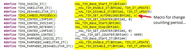

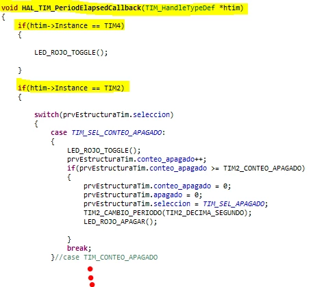

Elkin Granados
June 22, 2018
Posted on June 22, 2018 at 19:06
Hi
roseanne.qiu461
‌, based in the needes I would suggest to you the following if you are using HAL and CubeMX:
* Define in your program the periods that need to be counting at same time, I´m quite sure that there are instants where all 8 timers don't need to be counting at same time.
* Set all the timers with an initial period, enable all interruptions, set all in freerun mode, be sure that preescaler value is able to handle required times, and set different priorities for each timer.
* As programming
recommendation
, set macros to enable and disable interrupts, start and stop timers and change counting periods, there is an example of one code I made:
* In the main loop set the periods and the timers in the moment that are needed, enable the timers interrupts and start the counting.
* Using the HAL you must to take on count that there is just one function to handle all timers callbacks, so you must to check from which timer comes the interrruption with some like this:
* You should disable some interruptions to avoid that could be called meanwhile the interruption function is in execution.
* In order to check not only from which timer come the interrupt, you should declare a global flag to know which task is in execution (In the case that you are setting a timer with different periods).
* Don't make long codes in the callback function, instead set or clear flags that could be related in the main loop, I suggest to do the main loop as a state machine, if you make the state machine diagram of all your code you could see clearly where you have to set and start the timers.
Not sure if that could help to you, but works for me. Thanks

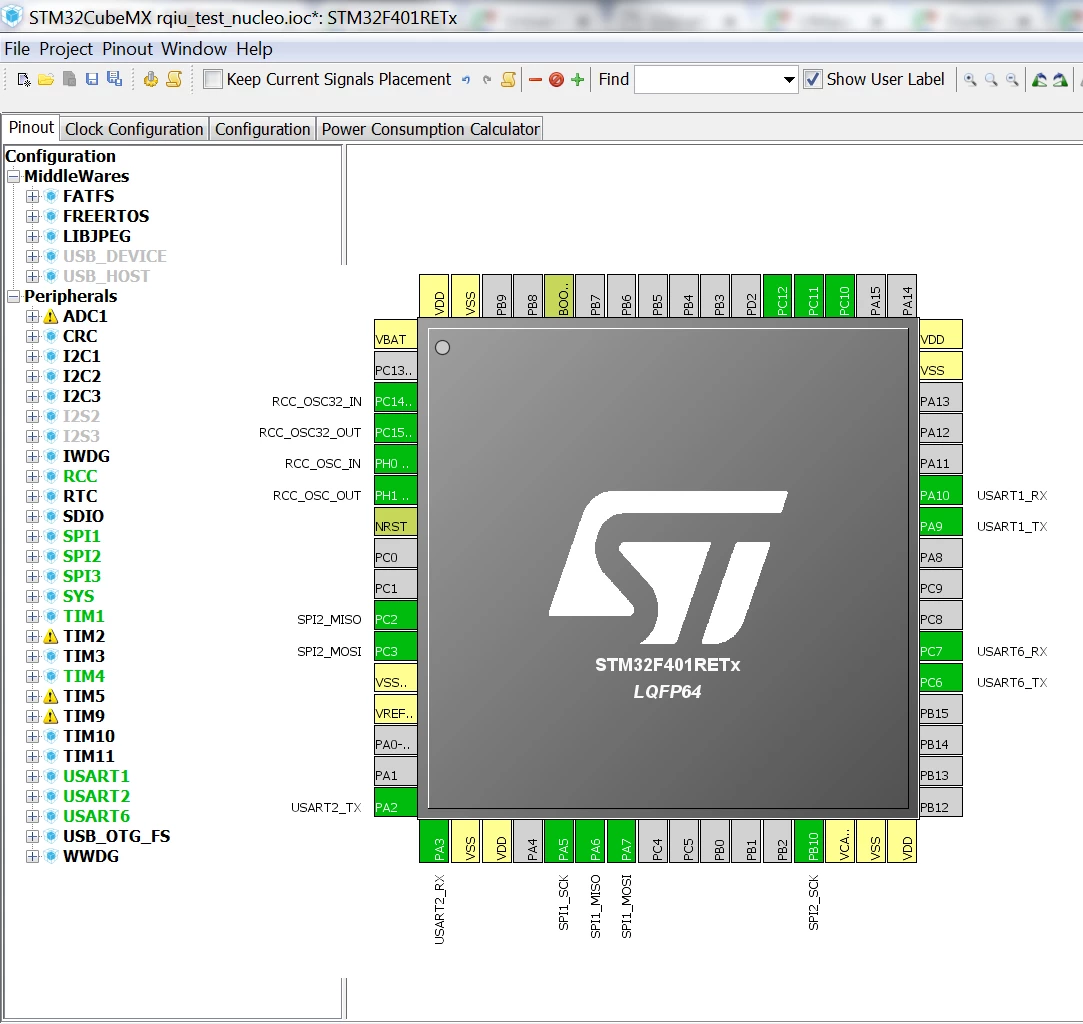

roseanne qiu
June 22, 2018
Posted on June 22, 2018 at 22:41
Dear Elkin and Dhenry:
I used the similar function you gave for Hal callback function for timer update(expire), I do not have the problem so far
I am struggling to try to use multiple channels of one timerf
