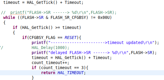

i am using the stm32g0b1cet6 controller. in which I am working with flash memory. I am using the FLASH_WaitForLastOperation function. In that function, one flash SR register's CFGBSY bit is not reset, and due to that all other flash write and erase processes it not working.
this issue is coming randomly.

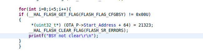

‎2023-06-25 11:58 PM - edited ‎2023-06-26 12:02 AM
I have found a fix for CFGBSY not clearing issue.
Write some random data to an address inside the page that you are going to erase/write before unlocking the flash for writing.

‎2023-11-28 8:05 AM
Hi Goutham,
Thanks for your input, I have tried with your suggestion, i found it is working as of now(tried 15 times)
Have you found the RCA for this issue? Why this CFGBSY is not clearing?

‎2023-12-07 1:22 AM - edited ‎2023-12-07 1:24 AM
MCU: STM32G0B0RE6
I was having similar issue with SBSFU and Application where watchdog refresh handler in application caused the problem. HAL Watchdog refresh handler in application not initialized in the application (No need to initialize in application for SBSFU projects) but refreshing watching with uninitialized handler caused to set CFGBSY flag in Flash->SR register then denied to flash write/erase operations.
I replaced HAL_IWDG_Refresh() with WRITE_REG(IWDG->KR, IWDG_KEY_RELOAD);
fixed my problem.
