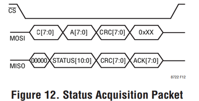

In pair with the LT8722 I use Stm32 Nucleo U5A5ZJQ and TECF1S Peltier device (7v and 1.2A)
Currently as I am trying to communicate with it through the SPI. Just basic status acquisition packet 32bit transmit and 32bit receive. I send 0xF0001491 and there are three cases.
  1. CS pin cycle (high->low->high->low->high) is done twice, one for tx and second for rx, separately. Results in 0x0690XXA5, which indicates acknowledged, but few UVLO alarms that I have no idea how to interpret since, only Vddio and Vin UVLO are explained in datasheet.
  2. CS pin cycle (high->low->high) is done. Results in 0x0690XXC3, not acknowledged, same alarms.
  3. CS pin cycle (high->low->high), but with TransmitReceive command, which sends them at the same time. Results in 0x0690XX0F, rejected due to wrong address.

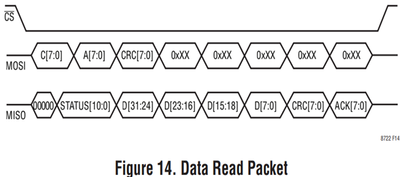

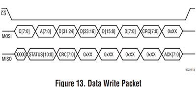

Regarding the other SPI packets Data write and Data read, I am lost, because it is 64bit receive and 64bit transmit. How can I send or receive through SPI at once, per one action whole 64 bits? Dividing it into array and sending one-by-one just make it think that every cell is an individual packet.
Thank you.

No, there is only 1 case shown in that diagram:
  1. CS goes low
  2. 32 bits (4 bytes) are exchanged on MOSI & MISO
  3. CS goes high
Have you used an oscilloscope or logic analyser to verify what is actually happening on the wires?

Yes, you are right with the device - LT8722 of Analog Devices. Three cases described are all related to the Status Acquisition packet behaviour. Each one of them gives different results, most important is that CASE 2, which is one in datasheet does not acknowledge communication (last C3 byte), while CASE 1 acknowledges my transmission with (A5 byte), but CASE 1 is not exactly what datasheet claims it to be. CASE 3 was a test of use HAL_SPI_TransmitReceive command, which seemed to be fitting to the "packet" concept, but instead it gives (0F byte) meaning rejection, because address is wrong, though address is same as in previous cases. I confirmed the CS behaviour set by me with oscilloscope, yes.
Regarding Linduino Evaluation Kit, I have looked into it, when I started working with LT8722, but it omits many important things in the initialisation process. This is essential in Stm32CUBE and is one of key problems I faced. Linduino Kit is inflexible and I need LT8722 in pair with U5A5ZJQ.
I would appreciate any experience related to controlling the LT8722 with the ST products or software.
