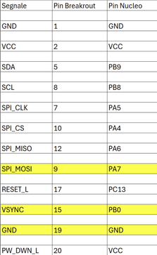

Hello everyone. I am writing to you because I am trying to capture a thermal image (frame of temperature values) using a Lepton 2.5 thermal camera with Break Out board 2.0 connected to a Nucleo U5A5ZJ-Q board. First I connected the following pins of the Break Out board 2.0 to the Nucleo board, as shown in the table below.
I checked the communication of the I2C on the oscilloscope and it seems good. Anyway I read 0 as the temperature of the case of the Lepton Thermal camera and I have never received the VSYNC signal from the Lepton Thermal camera to read the thermal frame on the SPI.
I tried to put software pull-up and to remove them on the I2C, but the situation remains the same.
Then I noted that about each minute the Lepton thermal camera shutter close and open for a while.
Do you have any idea how I can solve this problem?

Hello @ennioaloisini;
Can you share the Lepton 2.5 thermal camera datasheet?
Can you give more details regarding PB0 pin configuration?

Hi KDJEM.1,
thank you very much for the answer.
Here below the PB0 configuration.
Regarding the Lepton 2.5 thermal camera datasheet, please find attached Lepton datasheet, Lepton Software IDD and Breakout Board datasheet.

KDJEM.1
Hi  @ennioaloisini;
Thank you for sharing the lepton camera datasheet.
Are you able to read the device ID?  What SPI frequency did you use?
How to write your question to maximize your chances to find a solution - STMicroelectronics Community
I recommend you to look at AN5543 and at Getting started with SPI - stm32mcu and check the SPI configuration.

Hi @KDJEM.1 ,
I tried to read the device ID. I read 0. It is a strange value.
I used the following line of codes to read the device ID.

The bit 1 of the Status Register is always at 1. I removed the Step 3, but at the end I read 0 as Device ID.
I checked also on the oscilloscope and the I2C communication seems ok.
Regarding the SPI, I set the prescarel at 2 and the baud rate is 2.0 MBits/s.
Let me know!
Thank you very much for the support!

Hi everyone,
I tried to check also on the https://github.com/FLIR/lepton, but it seems that the functions that I'm using are correct. I do not know why I read ID = 0 and case temperature = 0 on the I2C. Probably the module is not ready to answer or there is some hardware or software problem.
Do you have any advices?
Let me know!
