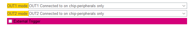

With the CubeMX 5.3.0 with the STM32G474RE V1.1.0 library is the assert_failed called when MX_DAC1_Init() is executed.
The DAC1 was configured as follow:
The assert was called from the "MX_DAC1_Init()" function

  sConfig.DAC_ConnectOnChipPeripheral = DAC_CHIPCONNECT_ENABLE;  // <<====

The  sConfig.DAC_ConnectOnChipPeripheral = DAC_CHIPCONNECT_ENABLE is the cause called by
assert_param(IS_DAC_CHIP_CONNECTION(sConfig->DAC_ConnectOnChipPeripheral));
The value for DAC_CHIPCONNECT_ENABLE is 6 but the macro "IS_DAC_CHIP_CONNECTION" tell is:
#define IS_DAC_CHIP_CONNECTION(CONNECT) (((CONNECT) == DAC_CHIPCONNECT_EXTERNAL) || \
                                         ((CONNECT) == DAC_CHIPCONNECT_INTERNAL) || \
                                         ((CONNECT) == DAC_CHIPCONNECT_BOTH))
#if defined(STM32G4)
#define DAC_CHIPCONNECT_DISABLE       (DAC_CHIPCONNECT_EXTERNAL | DAC_CHIPCONNECT_BOTH)
#define DAC_CHIPCONNECT_ENABLE        (DAC_CHIPCONNECT_INTERNAL | DAC_CHIPCONNECT_BOTH)
#endif
So the "IS_DAC_CHIP_CONNECTION" has an incorrect definition, because it checks only for:
  • DAC_CHIPCONNECT_EXTERNAL
  • DAC_CHIPCONNECT_INTERNAL
  • DAC_CHIPCONNECT_BOTH
and for the DAC_CHIPCONNECT_ENABLE  the macro must checks also the the combination of:
