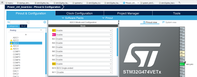

Hello Community,
I’m working on a custom board using the STM32G474VET3 MCU and encountering an issue with the ADC readings. I’m consistently getting a raw value of 4095 on all the ADC channels I’m using. It seems like something might be misconfigured, but I haven’t been able to pinpoint the cause.
Any insights or suggestions would be greatly appreciated.

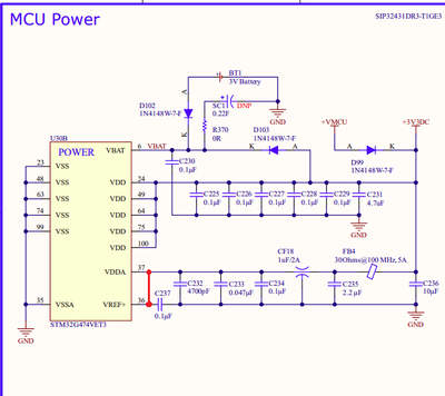

I think if you update this circuit by connection VREF+ also to 3V3 as VDDA, ADC will work correctly.   

Hl_st
can you please share your ADC settings.

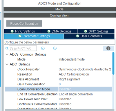

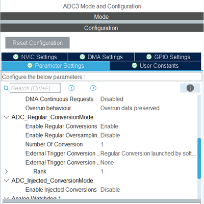

Sure
static void MX_ADC3_Init(void)
  /* USER CODE BEGIN ADC3_Init 0 */
  /* USER CODE END ADC3_Init 0 */
  ADC_MultiModeTypeDef multimode = {0};
  ADC_ChannelConfTypeDef sConfig = {0};
  /* USER CODE BEGIN ADC3_Init 1 */
  /* USER CODE END ADC3_Init 1 */
  /** Common config
  hadc3.Instance = ADC3;
  hadc3.Init.ClockPrescaler = ADC_CLOCK_SYNC_PCLK_DIV2;
  hadc3.Init.Resolution = ADC_RESOLUTION_12B;
  hadc3.Init.DataAlign = ADC_DATAALIGN_RIGHT;
  hadc3.Init.GainCompensation = 0;
  hadc3.Init.ScanConvMode = ADC_SCAN_DISABLE;
  hadc3.Init.EOCSelection = ADC_EOC_SINGLE_CONV;
  hadc3.Init.LowPowerAutoWait = DISABLE;
  hadc3.Init.ContinuousConvMode = DISABLE;
  hadc3.Init.NbrOfConversion = 1;
  hadc3.Init.DiscontinuousConvMode = DISABLE;
  hadc3.Init.ExternalTrigConv = ADC_SOFTWARE_START;
  hadc3.Init.ExternalTrigConvEdge = ADC_EXTERNALTRIGCONVEDGE_NONE;
  hadc3.Init.DMAContinuousRequests = DISABLE;
  hadc3.Init.Overrun = ADC_OVR_DATA_PRESERVED;
  hadc3.Init.OversamplingMode = DISABLE;
  if (HAL_ADC_Init(&hadc3) != HAL_OK)
    Error_Handler();
  /** Configure the ADC multi-mode
  multimode.Mode = ADC_MODE_INDEPENDENT;
  if (HAL_ADCEx_MultiModeConfigChannel(&hadc3, &multimode) != HAL_OK)
    Error_Handler();
  /** Configure Regular Channel
  sConfig.Channel = ADC_CHANNEL_10;
  sConfig.Rank = ADC_REGULAR_RANK_1;
  sConfig.SamplingTime = ADC_SAMPLETIME_2CYCLES_5;
  sConfig.SingleDiff = ADC_SINGLE_ENDED;
  sConfig.OffsetNumber = ADC_OFFSET_NONE;
  sConfig.Offset = 0;
  if (HAL_ADC_ConfigChannel(&hadc3, &sConfig) != HAL_OK)
    Error_Handler();
  /* USER CODE BEGIN ADC3_Init 2 */
  /* USER CODE END ADC3_Init 2 */
That doesn't show the STM32.
Also, you said "all the ADC channels I’m using"; that shows two - are there any others?
Have you probed the signals at the STM32 pins
The configuration seems to me OK. Can you share also the code where is used ADC and read raw ADC value?
Is it possible to test ADC on any unconnected MCU pin to know if there is problem in HW or in FW?
