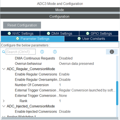

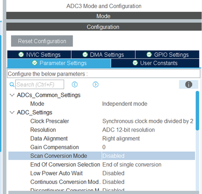

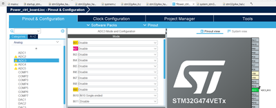

Hello Community,
I’m working on a custom board using the STM32G474VET3 MCU and encountering an issue with the ADC readings. I’m consistently getting a raw value of 4095 on all the ADC channels I’m using. It seems like something might be misconfigured, but I haven’t been able to pinpoint the cause.
Any insights or suggestions would be greatly appreciated.

static void MX_ADC3_Init(void)
  /* USER CODE BEGIN ADC3_Init 0 */
  /* USER CODE END ADC3_Init 0 */
  ADC_MultiModeTypeDef multimode = {0};
  ADC_ChannelConfTypeDef sConfig = {0};
  /* USER CODE BEGIN ADC3_Init 1 */
  /* USER CODE END ADC3_Init 1 */
  /** Common config
  hadc3.Instance = ADC3;
  hadc3.Init.ClockPrescaler = ADC_CLOCK_SYNC_PCLK_DIV2;
  hadc3.Init.Resolution = ADC_RESOLUTION_12B;
  hadc3.Init.DataAlign = ADC_DATAALIGN_RIGHT;
  hadc3.Init.GainCompensation = 0;
  hadc3.Init.ScanConvMode = ADC_SCAN_ENABLE;
  hadc3.Init.EOCSelection = ADC_EOC_SINGLE_CONV;
  hadc3.Init.LowPowerAutoWait = DISABLE;
  hadc3.Init.ContinuousConvMode = DISABLE;
  hadc3.Init.NbrOfConversion = 1;
  hadc3.Init.DiscontinuousConvMode = DISABLE;
  hadc3.Init.ExternalTrigConv = ADC_SOFTWARE_START;
  hadc3.Init.ExternalTrigConvEdge = ADC_EXTERNALTRIGCONVEDGE_NONE;
  hadc3.Init.DMAContinuousRequests = DISABLE;
  hadc3.Init.Overrun = ADC_OVR_DATA_PRESERVED;
  hadc3.Init.OversamplingMode = DISABLE;
  if (HAL_ADC_Init(&hadc3) != HAL_OK)
    Error_Handler();
  /** Configure the ADC multi-mode
  multimode.Mode = ADC_MODE_INDEPENDENT;
  if (HAL_ADCEx_MultiModeConfigChannel(&hadc3, &multimode) != HAL_OK)
    Error_Handler();
  /** Configure Regular Channel
  sConfig.Channel = ADC_CHANNEL_10;
  sConfig.Rank = ADC_REGULAR_RANK_1;
  sConfig.SamplingTime = ADC_SAMPLETIME_2CYCLES_5;
  sConfig.SingleDiff = ADC_SINGLE_ENDED;
  sConfig.OffsetNumber = ADC_OFFSET_NONE;
  sConfig.Offset = 0;
  if (HAL_ADC_ConfigChannel(&hadc3, &sConfig) != HAL_OK)
    Error_Handler();
  /* USER CODE BEGIN ADC3_Init 2 */
  /* USER CODE END ADC3_Init 2 */

@harshpanchal_6 and you still haven't said what voltages you measure at the STM32 ADC input pins.
As @Ozone said earlier, you need to get rid of all the other stuff and just concentrate on getting the ADC working.
The easiest way to do that would be on a Nucleo board.
I have check the input voltage also which is perfect
So is  on PD13 pin 2.8 V? And is on VDD, VDDA and VREF+ pin 3.3V?
