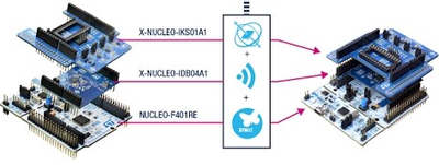

maybe i wasn't clear in my request . My question was , can i combine the two sensors together on the Nucleo board ( F401RE + X-NUCLEO-GNSS1A1 + X-NUCLEO-IKS01A2) and how can i configure the pinout .
‎2023-08-28 10:03 AM
Hi @khairi ,
You can combine the expansion board on the Nucleo board, as the X-NUCLEO expansion board is compatible with the Arduinoâ„¢ UNO R3 connector and the ST morpho connector, so it can be plugged to the STM32 Nucleo development board and stacked with additional STM32 Nucleo expansion boards.
Hope this answer your question.
