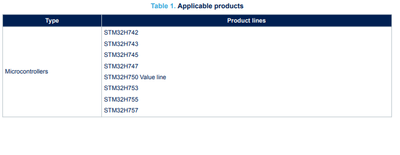

Hello @RongShengWang
I suggest you use one of the STM32H7 MCUs mentioned in this table:
More details can be found on the AN5354.
Best Regards.

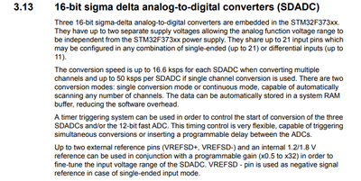

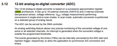

in fact, the STM32F3 will be the best choice as a price. But as you can see on the ARM®Cortex®-M4 32b MCU+FPU, up to 256KB Flash+32KB SRAM, timers, 4 ADCs (16-bit Sig. Delta / 12bit SAR), 3 DACs, 2 comp., 2.0-3.6 V the STM32F3 include 12-bit SAR and 16-bit Sig Delta ADC:
But, what you were asking for is SAR 16-bit ADCs that is available on the STm32H7 that I've mentioned you.

Sorry, i've forget to mention that the STM32F3 is the best choice based on the price. But, the STM32F3 does not implement SAR 16-bit ADC but SAR 12-bit ADC and 16-bit Sig Delta (not SAR) ADC as mentionned on the datasheet linked in my previous post (and the screenshos of my previous post).For the parts rhat we are toking about are the STM32F373 and STM32F378.
Best Regards.

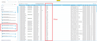

We've already provided you the answer: only STM32H7 family.
It's the same ADC characteristics over the STM32H7 family. Still to find which MCU part number fitting your needs (memory, GPIOs, comm peripherals etc ..).
You can use STM MCU finder tool or CubeMx to find one:
From STM MCU finder tool:
