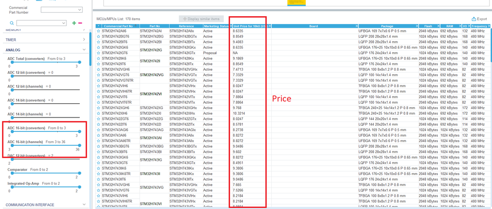

1) I really don't have the price in mind but you can go to the stm32MCUfinder and filter, search for those MCUs and select the price for the 10K unit. You can have it in order (increasing or decreasing).

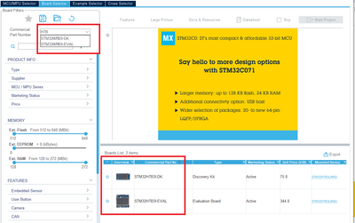

2) You will find using the STM32 MCU finder all evaluation boards (if available) for each of those  MCUs.
3) All the examples that we offer are available here on the STM32CUBEH7. All you have to do is to search for the evaluation board that you will use and select it to find all available examples.

Already answred that question in a previous comment. You need to use ST MCU finder tool:

Is there any applicable Evaluation Board for us to try first?
Many choices for the board:
Eval and Discovery:

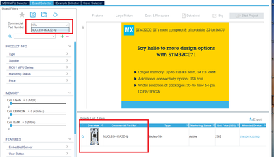

Nucleo board (cheaper):
You can use CubeMx and CubeIDE.
