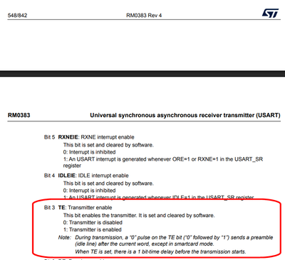

As well as enabling the UART peripheral, have you also enabled the transmitter:
Yes,
#define CR1_TE   (1U<<3)
USART2->CR1 = CR1_TE;

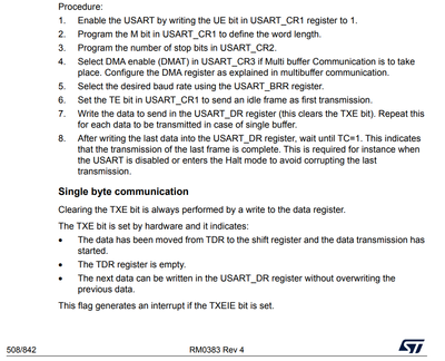

The procedure in the Reference Manual (above) says to enable the UART first, then the transmitter.
You do that "backwards":
	/* Configure baudrate */
	uart2_set_baudrate(APB1_CLK, UART_BAUDRATE);
	/* Configure transfer direction */
	/* Enable UART module */
    USART2->CR1 |= CR1_UE;
