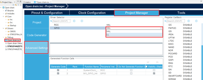

1. How can I let my STM32CubeIDE to generate same LL driver? is use LL encouraged instead of HAL?

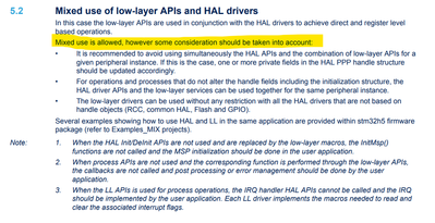

2. If I use example code function like Handle_I2C_Master_TransmitReceive() to interface with generated HAL code, will it work?

 1. Here is an example screenshot for generating the LL driver:
 2. Yes, it will work
You can take a look at this example in  STM32CubeH5. If you encounter any problems, please attach your IOC file.
