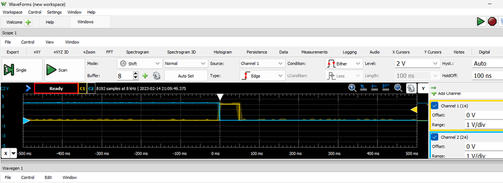

I at a high level I have designed a program to toggle the user LED on PA5 if a gpio input sees a high signal (shorter than 150ms) on PA0.
The program works well most of the time except in some instances when it will miss an input pulse entirely, seemingly for no reason. I have checked my timer delay function and even switched to a for loop style delay. This allowed me to validate that my timer was not the issue.
The bug only occurs when the output pin is low. (Never when it is high)

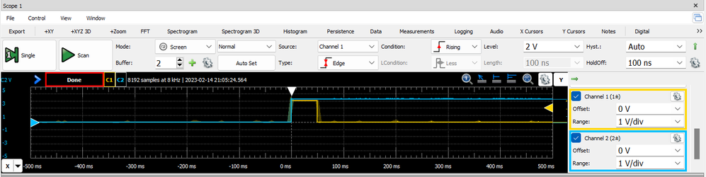

Scope Captures of Normal Operation (Input - yellow; Output - blue)

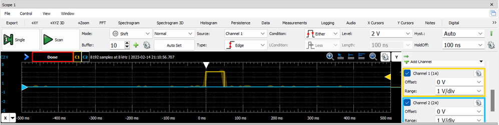

Scope Capture of the Insidious Bug

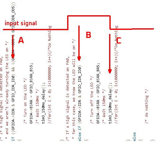

This happens if the input pulse's rising edge happens during execution of code between the first and second if():
A: (GPIOA->IDR & GPIO_IDR_ID0) is false, thus the whole first if() is false, proceeding to else-leg i.e. second if()
B: if ((GPIOA->IDR & GPIO_IDR_ID0) is true, so output is cleared (it's already zero so you see no change) and the 150ms delay follows
C: the input pulse is <150ms delay, so at the point where 150ms delay ends, the input pulse is already 0 again
You should detect the edge of input signal (i.e. "if previous level == 0 and current level == 1, toggle output level and do the debouncing (delay); remember previous level; loop). Loopdelays are good only for testing programs, you should learn how to get rid of them.
