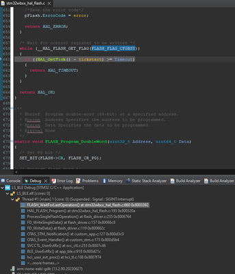

I'm using the P-NUCLEO-WB55 board and seeing an an issue when attempting an OTA firmware using the STBLESensorClassic mobile app running on iOS device. Execution is blocked waiting for the "FLASH_FLAG_CFGBSY"  to clear in FLASH_WaitForLastOperation() in stm32wbxx_hal_flash.c. Please see screenshot below of call stack and location.

Unexpected FLASH_FLAG_CFGBSY is with a 99,9% chance a null pointer error somewhere in your code. Multiple colleagues have managed to get this on STM32WB. As soon as you try to write to such a pointer, the controller actually tries to write to flash (since zero is the start of flash if you have boot from flash active) and fails because it wasn't unlocked -> FLASH_FLAG_CFGBSY is set until the next reset.
(this is WBxx specific behavior, e.g. on U5 it is a secure exception, and L0 just ignores it)

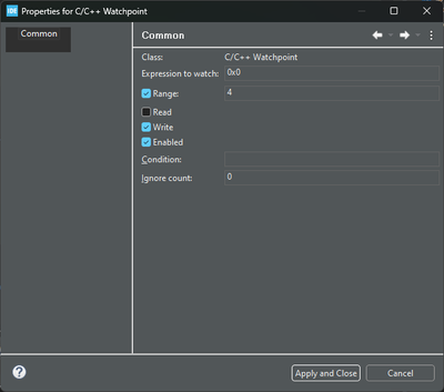

Thanks for the response. That explanation makes sense however, I put a watchpoint/data breakpoint at address 0x0 unlocked the flash and repeated the test but the breakpoint never gets hit. Am I missing something?

In 99.99% of the case, this issue is met when the Firmware writes any data in the Flash Area.
In almost 90% of those cases, this is due to null pointer which leads the CPU to write at address 0x00.
However, the write at any address of the Flash (not only 0x00) would provide the same result.
I am not sure how much easy it is to set a breakpoint on any write in range address of the flash.
As far as I know, the MPU could be used to help on this.
I would suggest two way to investigate on this :
1/ If the issue occurs on the very first value you try to write in Flash during FOTA processing, then set the MPU to generate a fault on any write in any part of the flash because that means something has been written in Flash whereas not expected at all.
2/ If the issue occurs after some writing in the Flash during the FOTA processing, then set the MPU to generate a fault on any write in the Flash except the download area. In that case, you may miss some unwanted write in the download slot out of the FOTA processing.
In any case, I would strongly recommend to focus on something wrong in the Firmware since so far, I don't think I have seen any other reason whether this has been reported by either customers or internally from ST team.
It should be related to an address in SRAM you need to write to, that has been corrupted and is unexpectedly replaced by an address in the FLASH range. So, instead of updating your variable/buffer, you attempt to write in Flash.
You may have a look as well if some error (especially alignment) are raised in FLASH_SR register. It does not strictly prove anything but if there are alignment error, this would reinforce the idea that the Firmware somewhere is writing in the Flash memory instead of SRAM. This could be of course the case even though no error are raised.
